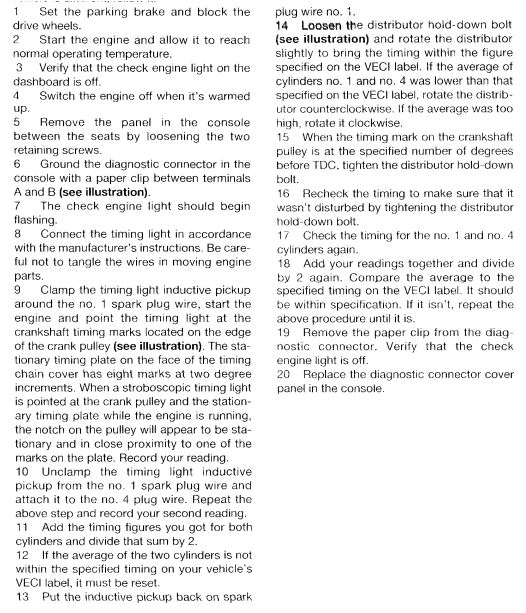

Use a timing light.
Pages 1-22 and 1-23 in the Haynes repair book.
I usually just connect to spark plug #1 and set to 10 degrees BTDC.

I purchased a timing light and I adjusted the timing to 10 degrees. It had been around 16 degrees, so obviously that was a problem!

Now, just today I was able to set the timing at 10 degrees.
And you did this with the ALDL jumper in place?

This morning, I decided to try (gently, slowly) rotating the distributor while the car was running normally (not in diagnostic mode) while I listened carefully to the engine. With my ear I could hear what sounded like a more optimal position. At that point, I put the computer in diagnostic mode and then got out my timing light. I could see that I was now on the right track. What I had previously thought was the timing groove was obviously some other mark on the balancer. NOW I could see a very obvious, noticeable groove all along the edge of the balancer, and it was lining up closer to where it should (around 14 degrees). I rotated the distributor a touch more, and I was at the 10 degree mark (more or less).
I guess that the timing had been SO far off before that I couldn't even see the right groove!
I then exited diagnostic mode and took the car for a good long spin on the highway. It never drove better! At idle, the RPMs fluctuate only from 900 to 1,000. No roughness at all. It was simply a timing issue - or more honestly, a human error issue.
