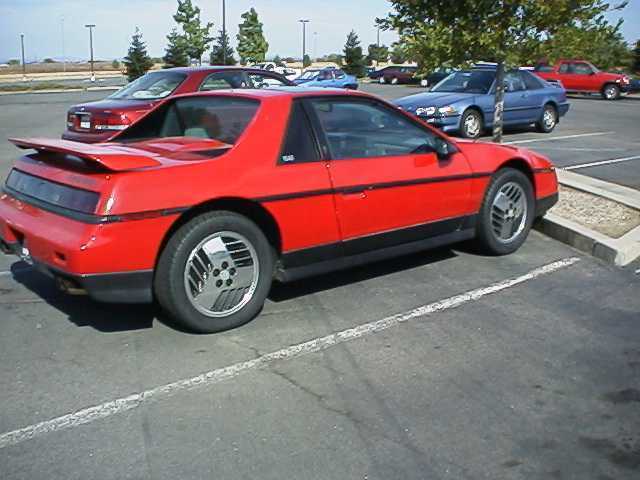

Report this Post10-11-2019 04:34 PM Click Here to See the Profile for DooberSend a Private Message to DooberEdit/Delete MessageReply w/QuoteDirect Link to This Post
I'm guessing these are the wheels? I haven't come across any 17" that fit that I like, may have to settle for 16".
