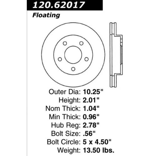

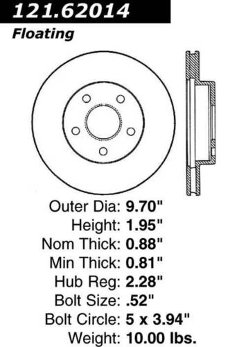

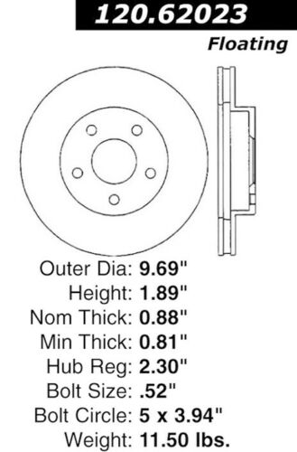

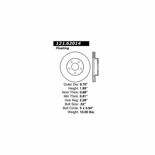

All of these 5x100mm rotors and calipers we are talking about are essentially the "Grand Am" brake upgrade for the 84-87... This is nothing new.
84 Citation Rotor:
88 Celebrity Rotor (light duty with 5x100mm pattern)
88 Grand Am Rotor (5x100):
88 Celebrity Rotor (heavy duty with 5x115mm pattern)

Looked at the specs for the Citation Rotors and they look like they would not bolt right on (no bearing hub) but provide the proper wheel spacing. The Grand AM rotors are entirely different than the Citation rotors but again the Fiero hub needs to be cut to fit these on.
