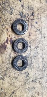

Hello All,
I am in the process of putting everything back together but can't seem to remember where some of the parts go. I forgot to take pictures prior to removing the parts.
Does anyone have a front suspension diagram?. Most of it is self explanatory. My main concern is where some of the washers go.
I can seem to recall where these go..
[This message has been edited by str8maxn (edited 10-22-2019).]

Report this Post10-22-2019 11:20 PM Click Here to See the Profile for str8maxnSend a Private Message to str8maxnEdit/Delete MessageReply w/QuoteDirect Link to This Post
str8maxn
298 posts
Member since Aug 2018
Could the mystery washer be the following?
wftb
Posts: 3692
From: kincardine,ontario,canada
Registered: Jun 2005
Report this Post10-23-2019 12:55 AM Click Here to See the Profile for wftbSend a Private Message to wftbEdit/Delete MessageReply w/QuoteDirect Link to This Post
Yes, those washers are for adjusting castor.
str8maxn
Posts: 298
From: Fontana CA
Registered: Aug 2018
Report this Post10-23-2019 01:03 AM Click Here to See the Profile for str8maxnSend a Private Message to str8maxnEdit/Delete MessageReply w/QuoteDirect Link to This Post
Thank you Mystery solved for the washers..
