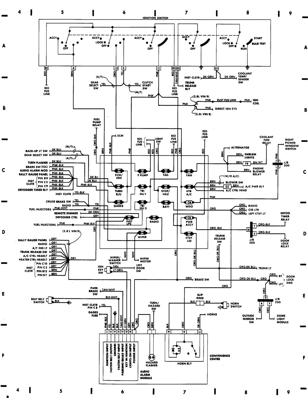

Where the heck is it? I've replaced it once before, but my chronologically challenged brain can't remember where it is? I don't see it on the fuse block under dash, and my buddy that's out of town has my manuals...

Thanks Gall, but this is showing me that the 'Batt' fuse powers the cig lighter plug, but everything else on this circuit works...Maybe I'll have to get into the wiring. I need the plug for my GPS...You would think that being the amperage it handles would warrant it's own fuse. Could there be an in-line fuse on the wire that plugs into the back of the plug?
