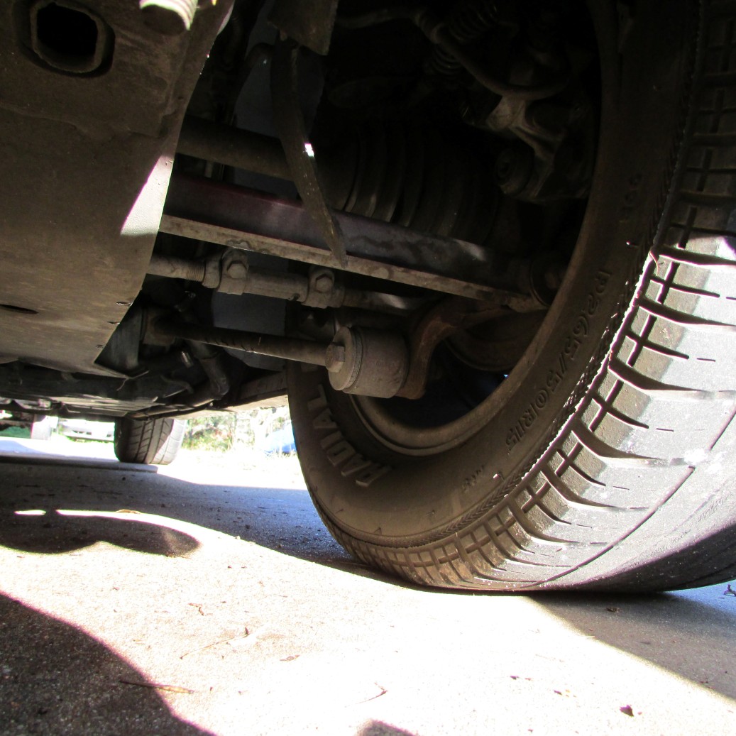

My '87 had 265/50-15 on it when I got it.
But, we probably need to know what you mean by "big" - are you talking sidewall or section? And on stock wheels or aftermarket? What ID?

Nope, that's an '87. '88 cradle swap, stock '87 15x7 wheels.

That's '88 suspension
I guess there is a good bit of sidewall bow visible.

I was impressed someone could convince a tire shop to put 265s on a 7" wheel, but they were there. The car was quite squirmy too, which was not confidence inspiring. The picture does not adequately capture the bow in the sidewall, but when you consider it's a 10.5" wide tire on a 7" wide wheel, it doesn't take much imagination.
[This message has been edited by thesameguy (edited 01-07-2019).]
That is well beyond the limits of a 7" rim for sure. lol
