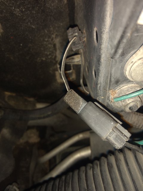

Report this Post08-29-2018 01:05 PM Click Here to See the Profile for JMTUTSend a Private Message to JMTUTEdit/Delete MessageReply w/QuoteDirect Link to This Post
Kevin,
Here is a picture of my connector on the driver's side hinge. It is a black wire with a white stripe. The wire on the hinge bolt is the ground run back to the hinge from the solenoid mount bolt. Your trunk may already have a wire in it.
