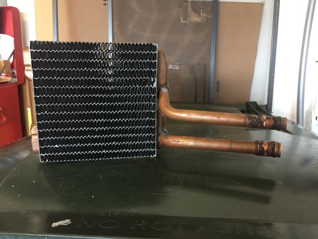

This is my heater core. It is a Harrison?

Report this Post08-26-2018 10:15 PM Click Here to See the Profile for PatrickSend a Private Message to PatrickEdit/Delete MessageReply w/QuoteDirect Link to This Post
It looks to me like an original heater core... and not like the usual aftermarket replacement(s).

Report this Post08-27-2018 09:52 AM Click Here to See the Profile for Formula OwnerSend a Private Message to Formula OwnerEdit/Delete MessageReply w/QuoteDirect Link to This Post
Thanks, Patrick. It looks better than I expected, so I wasn't expecting it to be the original. I guess I need to make sure I take care of it.

Report this Post08-27-2018 02:39 PM Click Here to See the Profile for fierofoolClick Here to visit fierofool's HomePageSend a Private Message to fierofoolEdit/Delete MessageReply w/QuoteDirect Link to This Post
That is an original Harrison. I just checked the number on the tag for the one I just gave to Sarge to bring over to you. Same tag. My blue tag has faded out, but the top number on the other tag matches yours.
Thanks, fierofool. Now if it just tests good....

Report this Post08-28-2018 01:36 PM Click Here to See the Profile for Formula OwnerSend a Private Message to Formula OwnerEdit/Delete MessageReply w/QuoteDirect Link to This Post
Good news. My heater core checks out fine.
