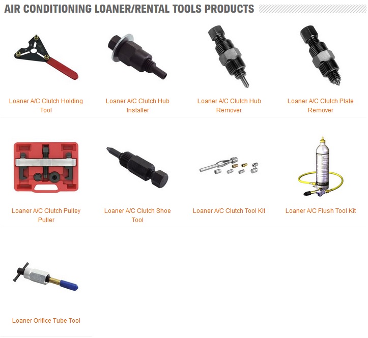

Now you're talking! Is the compressor from the Fiero, or the V8 car? The bearing comes off with the pulley. The bearing is like $20.
Bearing:
Autozone and probably other stores have the tools as part of their Loan-A-Tool program. Depending on the store, they might even let you just work on the compressor right there on the counter.
Or just replace the compressor
