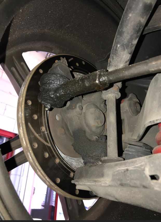

This is what my front suspension looks like when the car is on a drive-on hoist (suspension under load). To me it looks like there is no clearance at all for the bump stops.
Ball joints and tie rod ends seem tight, but is this much grease a concern?
thanks for any advice- I am not very mechanically inclined, so any tips/advice is greatly appreciated

That much grease just means that someone was over greasing the ball joints and tirerod ends. You can wipe it off, but don't use any water, as the seals had to have an opening for the grease to get out, which means water can get back in if much pressure is used.
