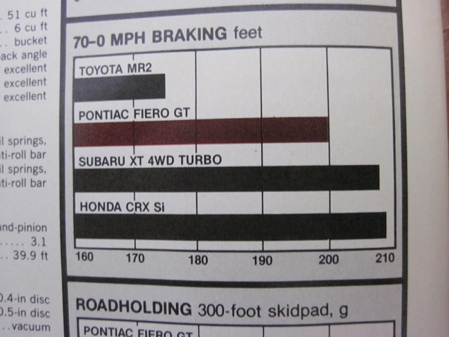

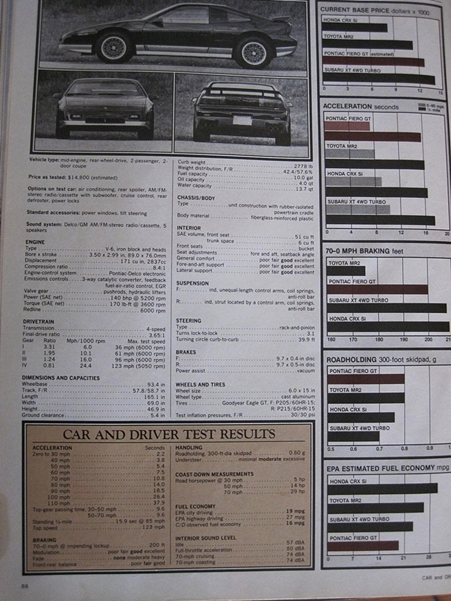

Here are the results of the 1986 Fiero GT as done by Car and Driver when the car was new with stock brakes. No track testing was performed but if you think the stock brakes are any good this might be an eye opener.
Hopefully the page is legible but really this graph is all you need to see:
The MR2 had the best brakes but really they are only on a par with modern econoboxes. Modern performance cars stop from 70 MPH in the 160 foot range. Fade was not really addressed because they did not track the car or take it in to a hilly area.
86 GT built 2.2 ecotec turbo

Originally posted by wftb:
Came in 2nd place out of 4

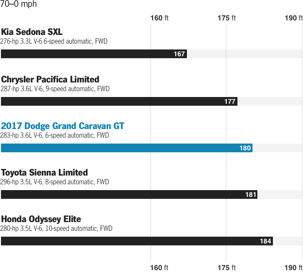

When the brakes for the Fiero were designed, they were designed for the stock Fiero wheel/tire package, stock curb weight, tire compound, and the national speed limit of 55 mph.
Today, there are lots of Fieros running with larger/heavier wheel tire packages, heavier that stock curb weight (sound systems, interior upgrades, body swaps, engine & transmission upgrades, etc), much better tire compounds (so the lockup limit is much higher), average interstate speeds are 75-85 mph, and in major cities you can be running 70+ mph to keep up with traffic with minimal distance to the car in front (if there is a 3 car length gap, someone will pull into your lane and take the space)... all of these items make the brakes work harder and generate a lot more heat than the design parameters back in the 80s.
Imagine a panic stop at 70 mph where the stock fiero on its best day could stop in 200 ft, but on this day you were following anyone of these minivans.
... Looks like a risky position.
Now ask yourself... Does your car have 16" and larger wheels? Do you have an amp, subs, lots of leather interior, or 50 lbs of stuff in the car? Do you have a 4 speed auto transmission or the F40, do you have a heavier than stock engine, do you have extra body panels that add weight? Are you driving faster than 70? If you answer yes to any of these, then there is an even higher risk.
Sure, keep 500 feet between you and that minivan and it doesn't matter, but how many times a day do you have someone jump in front of you and hit the brakes...
The Fiero brakes were adequate back in the 80s, but there have been a lot of changes since then both to the Fiero itself as well as the overall driving conditions the fiero will be subjected to.
I am not a fan of blindly stating that stock fiero brakes were good in the 80s, so they are still good for all fieros under all conditions, and in all environments, in 2018.
I am not a fan of haphazardly mixing and matching brake components.
I do think people need to make informed decisions based on their particular fiero, how they drive it, and where they drive it.

Sorry but most of this is same stuff that many think you can add bigger brakes springs etc to cheap trunks then haul heavier cargo. Wrong on so many levels and They find that cops can and will stop, force to put vehicle and often trailer on the scales then write a Big ticket for overweight. (Example: Virginia Big trucks often get $100's to $1000's in fines.) Cops Insurance Co etc go by GVW/GVWR as labeled in your car/truck and listed by manufacturer for use by DMV and others. Cops can stop a car for overweight/overloaded too Plus illegal lights, tint and many other problems... but yet YT is full of whiners claiming cops harass them.
Then Add that now most are Poor Drivers that Speed Tailgate and worse and wonder how you regularly get 2-10 vehicle pileups on most roads. (I'm waiting for lawsuits w/ auto-brake cars that "failed" for same reason.) But I don't "slam my brakes" often even then.
Stopping from 70mph are now a normal standard for many Countries. wftb only highlight a few in above chart but is tested w/ OEM pads and other parts like OE Shock and Struts. GM used iffy pads but also very cheap shock and struts and that's including WS6 and other RPO for many cars not just Fiero. Just w/ better pads and suspension parts, Fiero can stop in same or better distances as many current EU and other imports.
