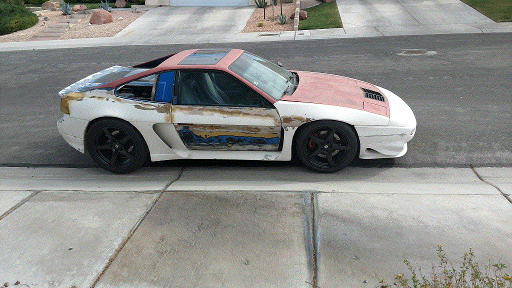

This is my car right now with a 2.8 and on 300lbs, 12" springs. It's a little lower, but not slammed. It rides nice, but I rub all the time in it. If I hit any kind of larger bump, like a bad bridge transition or a wide dip that gets the entire car to squat or rise on the suspension it'll rub. If I take a corner too fast it'll rub on the outside as well. 20mph or so type too fast, nothing crazy. I'm going up to a 450lbs for a 3800 swap and to stop the rubbing.
Thanks. What struts are you running, and a rear sway bar?
mr_corean
Posts: 437
From: Las Vegas
Registered: Mar 2005
Report this Post01-10-2018 06:11 PM Click Here to See the Profile for mr_coreanSend a Private Message to mr_coreanEdit/Delete MessageReply w/QuoteDirect Link to This Post
KYB, less than a year old. No sway bar. You should get your spring rates correct before messing with sway bars because of how they affect each other. In my case I need to get mine heavy enough that I won't have the straight line issues while still keeping my fillings in my teeth. At that point I can start looking at a sway bars to clean up the corners.

I'm only running 17 inch and only lowered approx. 1.5 inch. Your tires look large. Mine currently has 400 lb springs and a rear bar. I'm surprised you need stiffer springs the 3800 weighs less than my engine, I would think a bar would help your issues. But I know what you mean about the bar tying the sides together.

I've got 19's in the rear, but overall diameter isn't greatly increased. With that being said I am going to a tire that will shave me another half an inch in height and add another inch in width as well. The bar won't help the straight line rubbing, just the corners. Heavier weight springs will essentially act like a weak bar so I plan on going as heavy as I can while still keeping the car enjoyable to drive. Then add a bar to that and tune bushings, diameter, ect. to meet my desires. The 300's on the car now are soft and comfortable, but the rubbing has got to go. 450's are on the work bench, but I don't think I can get an alignment done on it before the LV drive here on Saturday. So I will be rubbing on Saturday, lol.

If you are rubbing like that you may want to raise your car up to give you more suspension travel. Now if it is just the look you are going after then dont even worry about it. It does look good with that stance though.
