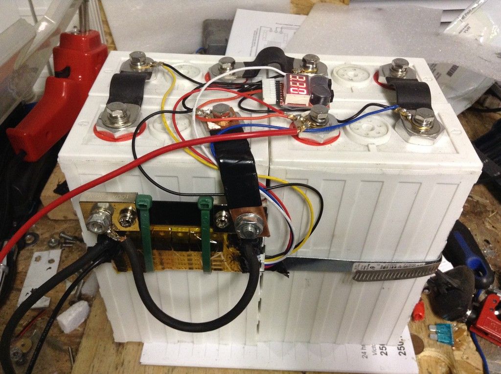

Curious if anyone has tried this. If you have a good idea of how the lithium 18650 works, it could be a great low cost alternative to those expensive lead acid batteries.
I have a collection of laptop lithium batteries. They are great and often have lots of life in them.

I was looking to build something for my bike. The typical lead acid battery for me only last two years.
Lithium batteries do charge and discharge differently. Each cell is fused because if not charged properly or discharged too quickly they can overheat. There is a condition called, thermal runaway. So lithiums have a Battery Management System (BMS) which monitors them both in charging and discharging. They even have temp sensors integrated to shut them down just in case. Pretty sophisticated!
There is no reason why they can not be adapted to a motorcycle or car.
The standard lithium battery is the 18650. I adapted some of my electronics around the house to this cell. They are great. I purchased a specific charger. They are small, powerful cells.
Often they are discarded from old laptops, power tools, and such before they are exhausted. So you can collect them and reuse them for projects. Tesla uses them in their cars!

First, the motorcycle lithium batteries are available ready made. They are much smaller and have a foam pad to take up the extra space. They are more rugged than I expected.. since they maintain 80% charge over a year, they can winter without discharging to the danger point.. cannot tell you how many dead lead batteries I replaced in the spring.
So then the big reason for Liion batteries over lead acid is 1/4 the weight, or 4x the charge density, depending on which way you look at it. That is huge.. lead acid project cars always had issues with extremely high tire weights, to the point of beefing up suspension. Both chemistries have very predictable charge/discharge profiles. But with liion, if you over or under charge a cell, you will likely destroy it. Non-recoverable.
Next, there is a large choice for you to make. You can put the batteries in some serial/parallel format, depending on voltage (cars need at least 180 or more volts to be responsive) and current (liion batteries have a discharge peak limit.. you must match that with the motor draw). But, you can charge the whole string as a single cell. Eventually, sad cells will unbalance the string, and cause additional sad cells.
One issue is that a cell that is used, or even cells from a different production runs, are going to be very prone to unbalancing. Once they unbalance, it becomes difficult to manage.
Or you can build up a charge system that maintains balance at the cell level. This turns out to be unwieldly complex, and is many times the secret sauce to commercial products. Most do it yourself BMS (battery management system) are so dangerous that they are notorious for catching on fire. Remember, 200VDC can be a very dangerous and potent fire starter.
There are also large format cells that you can get, so if you plan carefully, your series/parallel combinations are not so extreme. Something like..
http://www.electric-cars-ar...tteries-lithium.html
Look toward the bottom of the page.
And finally, you should read up on high voltage safety. A 200V DC pack is enough to completely (not partially or almost) kill you to the point of being dead.

Yeah, the technology is out there, and there are ready-made products, but I don't want to pay $200 for a battery.
I would like to experiment on my bike with a lith battery.
Of course I can monitor it better, but in my car I would worry about it overheating and exploding.
I am no expert on this technology. I only wondered into this arena after my laptop battery went to sleep.
But, like Dennis, I was amazed at the power density of these cells. At this rate you'll be able to start you car with a your cell phone!

Yes, they are not a drop-in replacement by any means. Lithium batteries are way more fickle than anything we have seen yet on the battery market.
I imagine the store bought ones that are such are designed with the necessary battery management system to deal with an old world lead-acid charging system.
My interest is in knowing if anyone has pioneered their own, built a battery pack, along with a functioning BMS.
Some bikers have and have documented their projects.

Report this Post06-04-2017 05:59 AM Click Here to See the Profile for Stubby79Send a Private Message to Stubby79Edit/Delete MessageReply w/QuoteDirect Link to This Post
It can be done. You just have to figure out how to get over each hurdle. Here's mine:
4x 60ah LiFePO4 cells. Small BMS & a shunt for an ammeter on the side. Weighs ~18lbs. (Use A123 20ah cells if you want to save more weight, but still have plenty of cranking amps)
I'm not running an alternator, but it wouldn't be too difficult to overcome that hurdle.
4x LiFePO4 cells have a maximum charged voltage of 14.6v, which is comfortably close to the 14.4v that lead-acid charging systems are usually limited to. 13.8v float voltage used for lead-acid will still permit cells to charge to ~98% full. Charged, resting voltage is 13.2v.
These cells are rated at 10c - meaning 600 amps for cranking.
BMS to prevent over charge or over discharge. (critical)
Shunt is for ammeter/amp-hour meter - not actually necessary with an alternator.
Starter pulls too many amps for the little BMS - easily solved by bypassing the BMS for JUST the starter.
The right BMS will let the alternator charge straight through it, and prevent over-charge; would need to be rated to handle potentially high charge current. To charge through a separate port or at lower current, you would have to use a separate circuit to limit current. Said components are affordable and readily available.
Relocate battery out of hot engine bay, just in case.
Run LiFeYPO4 instead for cold-weather starting/charging. Regular LiFePO4's will permanently lose capacity if charged below freezing, and have poor performance in cold weather.
LiFePO4 do not have thermal runaway issues, though over-charging or over-discharging can and will ruin them in a hurry. Hence the BMS.
Is it worth it? That's up to you and what you're trying to accomplish. Do it right, and it should last for years. Muck it up and you'll kill it in no time.

Report this Post06-04-2017 10:36 AM Click Here to See the Profile for Chris EddySend a Private Message to Chris EddyEdit/Delete MessageReply w/QuoteDirect Link to This Post
Very nice!!
I like the idea of bypassing the BMS for starting purposes. Then again, parallel some whopping MOSFETs, and you might just have the rating.
I see transistors below the current shunt. Is that part of the BMS? Is there an IC somewhere controlling?
Is the LED display just an off the shelf volts or some such?
The restriction of not operating below freezing is interesting. I did not know. So it would restrict to non-winter use, which is likely what most of us do anyhow.. but either way, the BMS can monitor temp, and refuse to operate below freezing. The BMS can supply ignition to the key/starter solenoid to allow it to prevent freezing operation.

Report this Post06-04-2017 11:26 AM Click Here to See the Profile for Stubby79Send a Private Message to Stubby79Edit/Delete MessageReply w/QuoteDirect Link to This Post
Originally posted by Chris Eddy:
Very nice!!
The transistors are part of the BMS. The shunt is the metal bar thingy above that, the rest of it is the BMS, wrapped in high-heat tape to keep the elements out. The transistors control the flow of electricity in to and out of the battery. If any one cell gets below a minimum voltage, it cuts off the power. If any one cell gets above a certain voltage, it stops it charging any more. There are also tiny resistors which bleed off power until the cells get back in balance. It also has short-circuit protection, so if you pull more than 120 amps out of it, it will cut off the power going out, protecting the battery and the BMS.
It's a simple BMS, the same type they use for electric bike packs. Doesn't do anything fancier than protect the batteries and itself.
The LED is both a display and a warning device. It's meant for Lipo R/C packs, but works fine here, as you can choose what voltage sets off the "beep". It will "go off" if any one cell gets below a set voltage...giving me a warning BEFORE the BMS cuts power off completely. It shows the voltage of the full pack, then scrolls through the individual cell voltages.

Report this Post06-04-2017 08:32 PM Click Here to See the Profile for RotrexFieroClick Here to visit RotrexFiero's HomePageSend a Private Message to RotrexFieroEdit/Delete MessageReply w/QuoteDirect Link to This Post
Wow, to the pic above.
You show that in public your gonna cause a lot of alarm. Looks like a bomb!!
