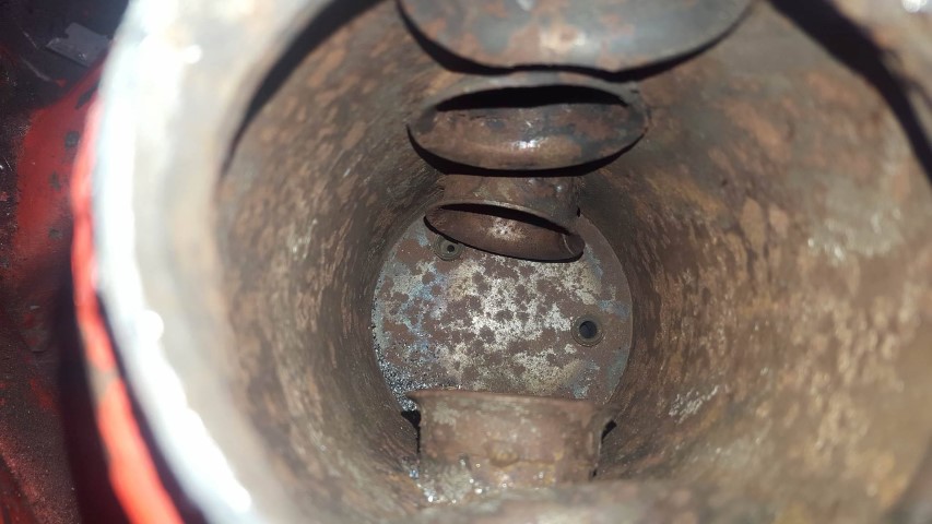

Has anyone gone back and re-dyno's their cars years after first installing the Trueleo intake?
When I first dyno'd my car and the intake was fairly new, I made 249 ft*lbs. 4 years later I was making 220 ft*lbs. 3 years later I was making 203 ft*lbs. Some of this power loss is due to switching to bigger wheels and tires, but it seems not all of it...
After cutting off the neck to weld on a straight neck instead of S shaped neck, I found lots of internal rust. I've since switched to a ported FIREBIRD 2.8 intake (since I run DIS and don't need the S shaped neck) and I'm close to having the car on the road... Over the years I've had to keep cutting back fuel... Now my mechanic friend says the car is running LEAN with the Firebird intake. So it looks like I'll be adding fuel back (and hopefully getting back the power I've been losing).
So I'm wondering if anyone else has had a similar experience with the Trueleo intake. Great idea, bad material choice is what I'm seeing.

The Trueleo intakes are made of steel. I find it hard to believe that the intake would build up so much rust inside that it would choke off the airflow.

Could you post up pics of the intake? Steel rusts. There is quite a bit of moisture within the system. I know of no manufacturer that makes steel intakes on their vehicles. Aluminum or plastic is what I see.
Just thinking here. Nothing else.
I posted pics in my other thread.
https://www.fiero.nl/forum/F.../075502-18.html#p691
I failed to mention I rebuilt the engine between in 2015 and put in a bigger cam and the result was I lost 5 more hp but gained 3 ft*lbs of torque and my peak torque moved down 400 rpm but that was due to the cam...mostly. I too, Dennis, assumed I had a compression issue.
What I have learned is airflow is very dependent on the walls it flows thru. So rusted walls increases turbulence and ends up restricting airflow. Rust only increased over time.

Holy heck! When you are done modifying that and removing all of the rust, have it powder coated inside and out. Something is definately getting in your engine.

Yep, that is a crazy amount of rust inside an intake. I would not want that on my car. Any piece of rust that comes off can potentially cause damage.

Do things rust often where you live? Not excusing this mess, but I am curious if the moisture of the air or something played a part or if this is something that will happen to every Trueleo intake no matter where the car is used?
I guess this is what happens with one off parts built by hobbyists. I really wonder why at a bare minimum didn't he put on a weld through primer on the inside? Or the part could have been submerged into paint and hung to dry. My detail shop at work gets these 5-gallon buckets of black paint they spray on the undersides of cars when they detail them, that probably would have worked well in this situation as its goes on pretty thin yet covers well.

I pulled mine last year to have it powdercoated, and there was zero rust inside. Its been on the better part of a decade in humid vermont. Cant speak for all of them, but i can say its possible yo have one not rust.

I am curious if the rusted one has the stock PCV system and/or the EGR operational. The oil mist from the PCV system tends to coat the inside of the intake with an oil film. The EGR allows carbon/soot to build up as well. Both of which should greatly reduce the risk of rust, even with unpainted steel.
No I block all emission stuff on the race car. I use breathers on the valve covers. An intake shouldn't be made out of iron.

How long have you owned it? I first got mine ~2010 ... If you have emissions hooked up, the inside probably got coated with oil and carbon...

So it would seem that a steel intake is OK, provided that you are running PCV.

If the tubing was finished by the Drawn Over Mandrel process, then it's likely either AISI 1020 carbon steel or AISI 1026 carbon steel.
These types of steels will rust easily.
To fix your present situation, I would suggest a hydrochloric acid bath to clean the inside, followed by a soaking in lye to neutralise the acid.
Then, a sandblasting of the exterior, and self-etching primer + bc/cc or single stage urethane for the outside.
The last step would be to spray oil on the inside, and somehow try to get it everywhere.

I do have a coating of oil on the inside, which im sure helps.
