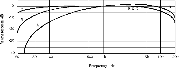

A-weighting simulates a human's perception of sound at low volume levels (see Fletcher-Munson curves). As long as you don't blast the music, this should be OK.
You could get an A-weighted SPL meter, place it near your head, set the volume knob (and no longer touch it), and then measure the decibels with a 1 kHz test tone.
Fiddle with the treble/bass knobs so that the indicated decibels at various frequencies have the same as the reading as at 1 kHz.
You should be able to download test tones (sine waves) in different frequencies. Maybe use a cassette adapter to get the sound from an mp3 player (with equalizer disabled) to the car audio system. Youtube might even have test tones.

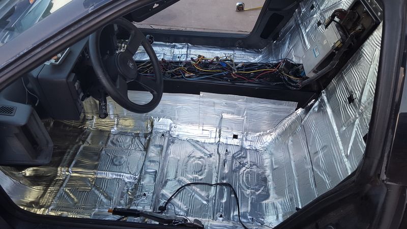

The single best thing you can do to any car for better sound is sound matting. Its not easy to do because it does require a lot of labor but at the end of the day it is worth it. Besides everyone here seems to tear apart their interior anyways so it should be a no brainer.
