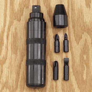

Impact Driver.
https://www.amazon.com/Reve...manual+impact+driver
You hit the end with a hammer to give a 1/8 turn twist to break screws loose (or tighten).
Motorcycles use a lot of Philips head screws and this is the only way to break them loose.
The weight of the hammer gives the twist, but also 'pushes' the bit down into the screw head.
