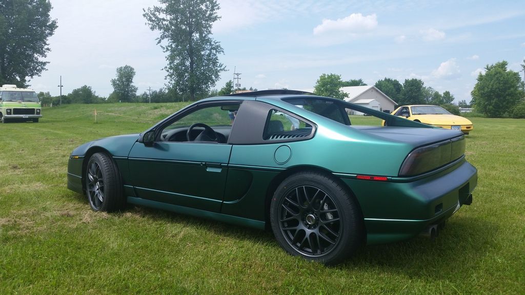

One of my rare forays here into the Tech section.
I saw this on a recent episode of MotorWeek, which bills itself as "Television's Original Automotive Magazine."
I just want to put this up for general interest, and to see if the paint experts here have any thoughts about it.
Peelable Paint... Autoflex from KP Pigments
http://www.motorweek.org/fe..._edge/peelable-paint
“Even though the guys tell us that this spray should last the lifetime of the car, when you’re ready for a change, you walk up to it, get a little piece started, and you literally just start peeling [it away] . . ."
My concern would be what happens if you incurred some small damage, like brushing one of the front quarter panels against the side of your garage door opening. Seems like you might have it start peeling away by accident. What then? Could damage to a small area be repaired without redoing the entire body panel?
Also wonder whether this would be as compatible with the plastic body components of a Fiero, VS steel or aluminum-bodied vehicles.
Autoflex Gloss with OEM+ Pearl
Concord Purple Pearl BMW 335
https://www.kppigments.com/...rple-pearl-bmw-335xi

Originally posted by qwikgta:
you can get a good paint job with spray paint. I did my car 6 years ago and it still looks great. I used Krylon paint I bought at Walmart for $2.99 a can. I took my time, removed each panel, sanded, primed, sanded, panted, sanded and painted again. No runs, no sag's and it look great. I get just as many complements on the paint as I do the LS3. Paint is paint, and a spray can or a paint gun, its all about prep and patience. I've looked at the dipmycar videos and i've been thinking that it may be something I do in the near future.
Good is relative. With a flat finish like yours or primer, you can get an 'acceptable' paint job from a spray can. You WILL NOT get it with a nice glossy finish. The material in a spray can is too thin, too little amount, and way too little air pressure to get a decent pattern. You may get away with it on some panels, but not on anything like a hood or trunk lid. Ive tried and it simply dont happen. It can be compared to painting a wall with a 1" paint brush. IF you spray can it with 30 cans of paint, wet sand it, and buff it out 2 months later...it may look passable with a lighter color. Ive done it all, brush painted cars, spray canned em, spray gunned em and even a poor spray gun job far surpasses what you get any other way.
