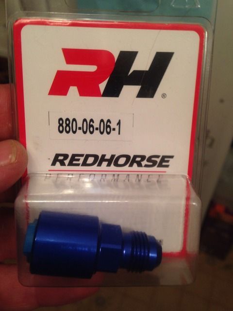

This is what you will need to connect your fuel line to your steal braided lines, its plug and play!!

Another thing to keep in mind is that the fuel rail has two sizes for the 3800na,
One closest to the cab is a 5/16" 6AN male to 5/16" (Hard Tube) SAE quick-disconnect female part# 880-06-05-1
The side closest to the rear of the car is a 3/8" part# 880-06-06-1
these can be purchased directly from RedHorsePerformance.com or from Nickel's Speed Shop

Early on I used a 3/8" tube flare nut to a #6 AN male connector. Now I use what you show but the Russell brand I use the 3/8" clip on tube to #6 AN male, on the single fuel rail of the series III 3800SC.. The Russell connector actually tightens on to lock it in place.
