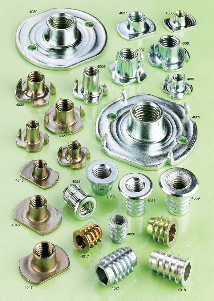

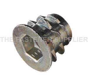

Some people use a threaded insert such as these, epoxy it in, then a bolt into it. They are threaded on the inside.
I believe that is usually done when the factory ones are stripped out though.
Choices choices:
