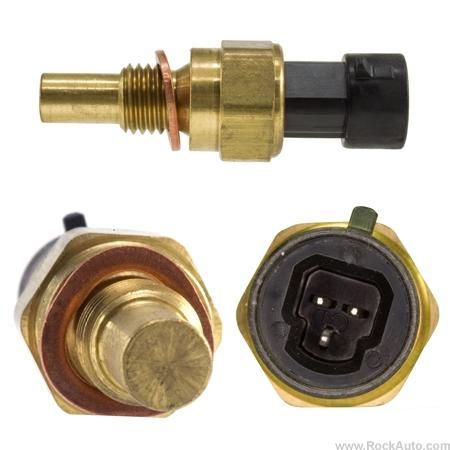

The connector right under the thermostat. The thermostat is located right under where the upper radiator hose connects to the engine. You can see the connector wire between the exhaust pipe and the valve cover.
Most NA 3800s were equipped with a 2 pin CTS. That doesn't support an external temp gauge. So most swap the two pin CTS for the 3 pin CTS & temp gauge sender combo.
This is the three pin CTS & temp gauge sender combo
This is the two pin CTS
