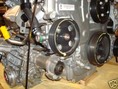

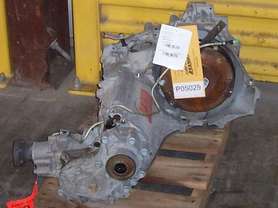

I have looked at the options for an AWD Fiero several times... Like others have shared, Fiero is just the FWD drivetrain moved to the rear of the car, no flipping. The transmission is on the driver's side of the chassis.
GM front engine transverse AWD setups have the front axle shafts on the rear side of the engine (or the engine is in front of the front axle center-line). This allows the power takeoff (really a transfer case type function) to have a direct path to the rear differential located at the rear axle center-line.
The issue with using this setup in a Fiero is this power takeoff still points to the rear of the Fiero (trunk/muffler area) and the engine is physically between the front and rear axles. To get the power take off to point to the front, you would need an adapter plate to flip it 180 degrees. The real issue is if you do this, the power take off would be pointing right at (likely interfering with) the oil pan of the engine. If this is below the spinning counterweights of the crankshaft, then you should be able to mod the oil pan for clearance. It is is not, then you are looking at running another adapter plate at the engine/transaxle interface to rotate/clock the transaxle to lower the axle center-line vs. crankshaft center-line... Once that is done, then you mount the AWD rear differential in the front of the Fiero, but it would need to be mounted upside down to have the wheels spinning the right direction.
Lots of details to work out as well as significant fabrication... but it "might" be possible.
Here is the AWD setup from a 4t60/65 transmission. Clearly the power take off points to the rear and flipping it 180 puts it right into where the oil pan would go:
Here is the AWD setup for the F40. Again it points to the rear. The bigger issue with this one is the power takeoff is lower than the axle centerline. So flipping it 180 raises the location of the driveshaft that will connect to the end of the power take off... making interference with the crankshaft counter weights even more likely.
