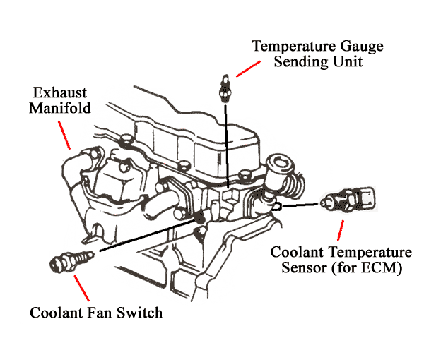

Report this Post12-14-2015 10:37 PM Click Here to See the Profile for PatrickSend a Private Message to PatrickEdit/Delete MessageReply w/QuoteDirect Link to This Post
Originally posted by Roadtrip:
...I have a toolbox that would allow me to isolate and expose the ECM, however, that would be as far as me technical trades go!
It's more the Coolant Temperature Sensor that I'm suspicious of. There are ways of testing it with a multimeter. If you can't find something about doing this in the archives, perhaps someone who's familiar with the process can chime in.
Just remembered...last trip to my mechanic, I left it running while I waited for him to clear a bay...the cooling fan didn't come on (and it had been functioning because I'd checked it, I was blaming the ECM) and it was running hot when I climbed in...Coolant Sensor???
No. Check the diagram above. The fan won't be switched on until the coolant reaches 235°F (with the factory setup).

Posting from my phone so I can't give a link. Patrick's suggestion for testing sensors can be found on the message board at WWW.gafiero.org
Enter "chart" in the search box and the GM sensor tech tip will come up.

Got home and pulled up the chart link for you. But we'd still like you to visit our website.
http://www.gafiero.org/bbs/...=641.msg4644#msg4644
Posts: 38443
Total ratings: 465
Report this Post12-15-2015 04:41 PM Click Here to See the Profile for PatrickSend a Private Message to PatrickEdit/Delete MessageReply w/QuoteDirect Link to This Post
GM Temperature Sensor Chart
Helpful chart... and now we've got a JPG image of it as well.
