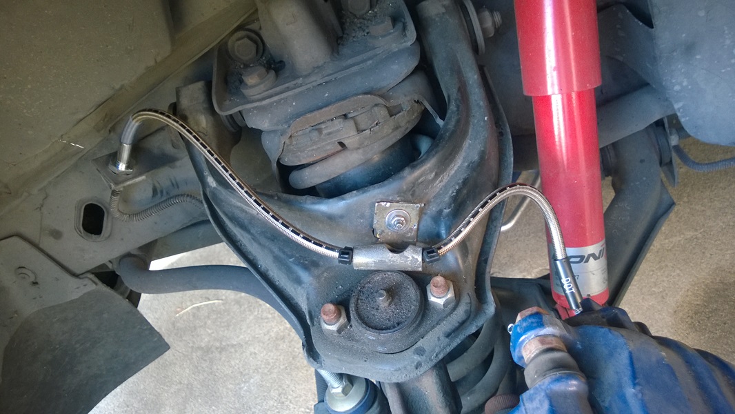

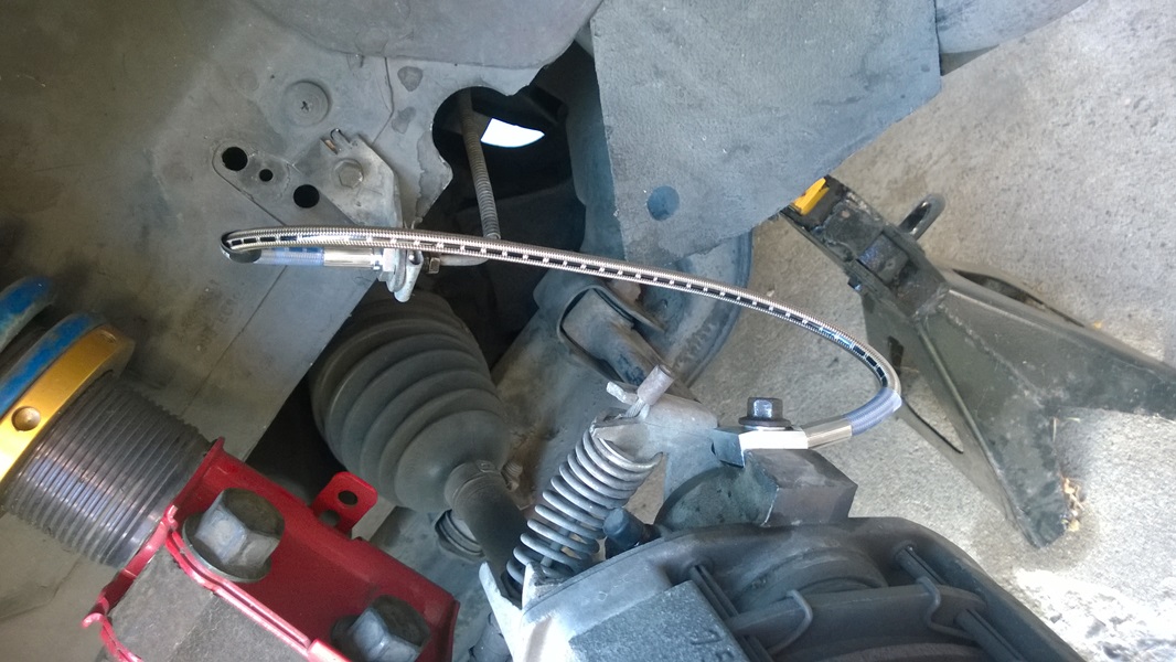

As he loads it onto the flatbed, I can't help but notice one wheel stud is broken on each of the rear hubs. They weren't like that two weeks ago when I checked air pressure, so it's another fun broken thing. Stoked that there is strong evidence of how hard I drive it. Looks like the Fiero gets to chill while I order it some parts.

I used ad Advance Auto Parts $40 off a $100 purchase to pick up some Russell stainless steel brake lines for $60. At about $8 more than quality rubber lines, it was a no brainer.
It wasn't nearly the PITA I thought it was going to be, and I'm glad it's done.
I've never used Russell brake lines before, and they are kind of a mixed blessing. I enjoy that they are coated top to bottom, and that dotted line is a nice touch to ensure the brake line isn't twisted. The fittings, however, are a little lacking. The body side doesn't have a "washer" to set against the bracket like the factory lines do, and the knuckle side has an oddly cut banjo fitting. Ultimately, that's ok - what I do not like is that the factory lines have a metal section to direct the line away from the wheel, but the Russells are flexible top to bottom. This may pose a problem. and I have no idea why they would do this. Working in my favor is a much larger than factory wheel that may keep the entire thing wheel inside the rotating parts. Fingers crossed!
Initial drives are good, and pedal feel is definitely improved. I believe the cracking rubber pictured above is just the outer protective layer and does not figure into the actual mechanical qualities of the brake lines, but I don't know so I can't rightly say "stainless steel is better than rubber" in this application. Not too worried about it - they fixed my issue, cost no more than stock lines, and even if they aren't an improvement they certainly aren't a step backwards.
With any luck, this is the last Fiero work for me in 2015. Looking forward to another year of reliable mid-engine motoring!
