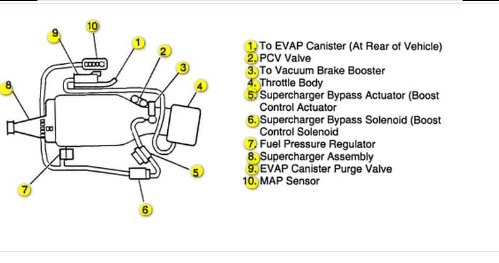

i get all kinds of conflicting advice here about the vacuum routing on the 3800 SC - L67. My car is all stock manual transmission with all sensors. The advice doesn't agree. Here are two differing diagrams:
screen capture
and from another thread:
And then another guy says i need to use the hard plastic lines rather than rubber hose.
What should i believe?
