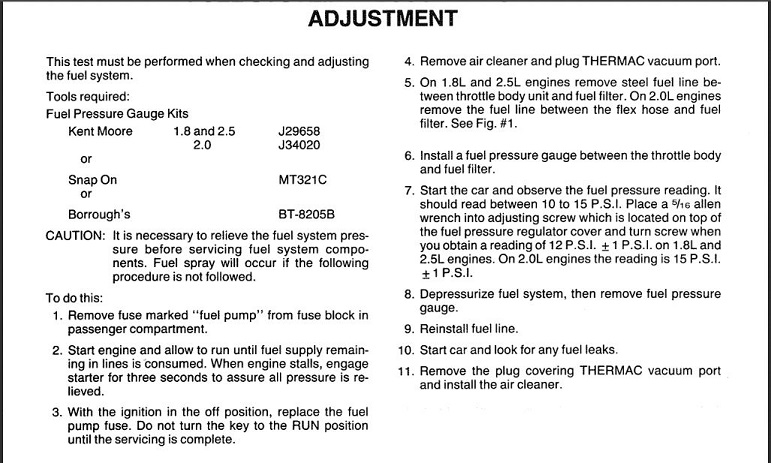

I did adjust the fuel pressure regulator up a bit after I installed the Holley.
Not sure how to adjust the regulator without using an exhaust gas analyzer
Here are the tuning instructions from the Holley install doc:
1984 Indy Fiero

Using your scan tool; Follow the O2 sensor voltages while driving. They should be .5V or lower under normal driving conditions and near .9V at WOT. If you do not want to invest in a scan tool buy a low cost air fuel gauge. That will give you some idea (although rough) under what conditions your engine is running rich.
Bad mileage can be caused by many factors; timing, manifold leak, weak coil, bad plug wire, defective ETC (my guess) , leaky injector, and high fuel pressure.
