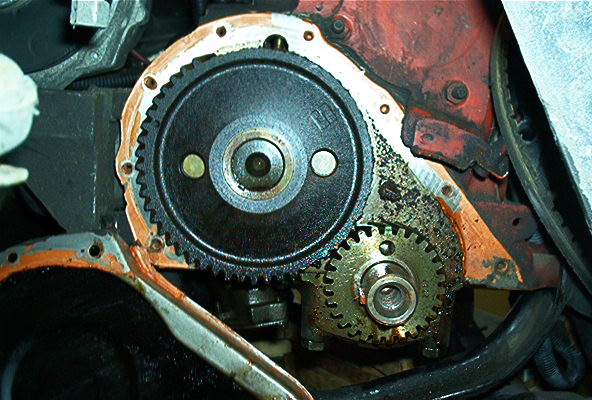

I pulled the cover and the gears line up. Not a timing issue. May have had the wires installed wrong, but I doubt it. I had the diagram out in the garage when I put the new plug wires on.

One gear is fiber and it doesn't slip, it strips... If the valve train is moving the gears are fine (well, good enough to run the vehicle at that moment).

I've seen a lot of Dukes with stripped gears, however that doesn't seem to be your problem. Since you have the heads off I would suggest putting some thin oil or trans fluid into the cyls and see if it drains straight through. If it does your rings are shot.

Report this Post11-25-2014 11:56 AM Click Here to See the Profile for jaskispyderSend a Private Message to jaskispyderEdit/Delete MessageReply w/QuoteDirect Link to This Post
jaskispyder
21510 posts
Member since Jun 2002
How the timing gear should look... and align (notice dots).
Stripped gear... for other posters...
