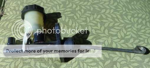

My clutch was weak so I thought it would be a good time to change out my clutch master cylinder and slave cylinder and get a new set from Rodneys Dickman. The problem I ran into was with ordering the clutch master. Its a '86 so it could be one of 4 variations. 1st it has the fluid line in the front of the reservoir so I know I need the LATE style. This is were is gets a little confusing, the banjo size. According to the pics shown at R.D.'s,
http://rodneydickman.com/ca...roducts_id=280{8}191 I need either a early large pin sized banjo or a late style which is smaller in diameter. My clutch pedal looks like neither clutch pins shown.No couter pin hole, and with a grove that a black bushing inside the banjo slides on. I measured the clutch pin with a digital caliper and it reads .42 inches/10.7mm o.d. The banjo opening reads .49 inches/12.5mm i.d.
I'm leaning towards the late style cylinder with the large banjo? Pics below...
My clutch pin...
Rodneys clutch pins early '84-86 bottom,late models '86-'88 top one...
My clutch master cylinder...

I'd hate to take the assembly off and grind off the pin and get your adapter but I may have to. diameter I posted of the pin were no help? remember, there was a black plastic bushing I removed that took up some slack.thanks.

Possibly my late style small pin master would work. Possibly the bushing you have in your master might swap over to my banjo?

I bought the car in '94 and looked 100% factory but I'm the 3rd owner. Here's some more pics. Let me know if I need to measure something or whatever. My order will be placed as soon as we figure this thing out. Forgot to mention, if need be I have a '87 & '88 2.5 fiero's with manual trannys I could part out. Maybe i could change out the assembly?Thanks for the help!....jesse

Could I drill out the hole if needed on the smaller late style pin? Better to make one bigger than try to fill the slack with a bushing on the earlier model right?
