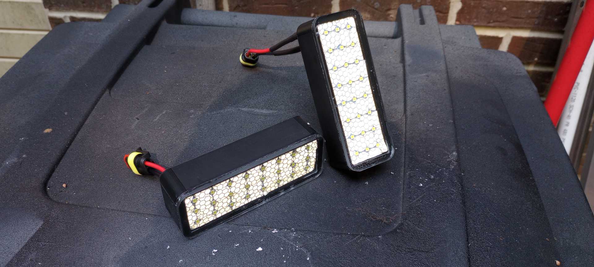

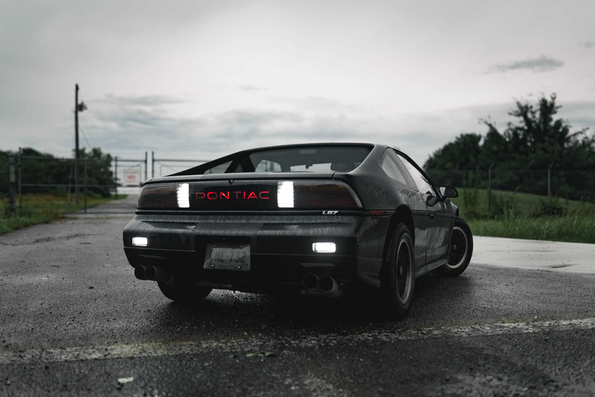

I have made several sets....just using lights bought from Walmart to Amazon. Machined a housing from black delrin then a lexan lens. The set on my Black 3800SC '88 are my favorite so far.
