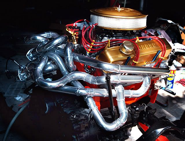

It's interesting that this subject is being discussed. I built these headers 10 or 15 years ago and I could never get the heat out of the engine compartment. The rear window got too hot to touch. I've got the engine out and am looking at the Sanderson CC1-34 shorties. Yes, using the shorties may cost a little bit of power but I'll sacrifice that for practicality.

I saw your old page on hotrodders.net IIRC... That's a lot of heat way up high in the engine bay, especially with the main exhaust pipes coming around the front of the engine and following the stock routing.

Before I jumped ship to the LS(x) platform, I had these mocked up for my old SBC swap. I wanted to keep the clutter of snakes hidden with nice streamlined pipes visible from above.

Probally best you didn't use those pipes. Those run awefully close to the distributor. My bet is it would cause some hiccups.
I mocked it up with the large HEI distributor, but my engine used the small remote coil one. So there was plenty of room for some metal heat shielding. My longer term plans were to convert to the EFI Connection 24X where the distributor just becomes a cam sensor and it used the LS1 ecm with remote mounted coils. Then heat wouldn't be any issue.
Old swap:
EFI Connection 24x distributor on another SBC (HSR with the upper plenum flipped):
