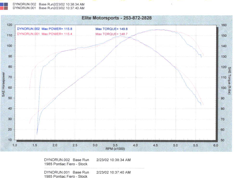

Stock 2.8L dyno chart... you can see calling the power usable up to the 5500 yellow line is being a bit optimistic.
There is nothing to gain by keeping a stock 2.8 above 4500RPM...
My 2.8 GT pulled well past the 4500 rpms you speak of. Easily up to 5200-5300. And 6000 never hurt it any. It was running good when I pulled it for my swap.
It will rev that far, yes. It does not make power up there though, so it's just a waste of gas to make some noise.
If you read my post, I was talking about power output not maximum engine speed. I have an 88GT with a 3 speed, I know all about high RPMs on the freeway.

As far as the power curve discussion, GM rated the peak output at 5200rpm. That seems roughly inline with seat of the pants on my car, although I could be peaking a little below that.
Whether it makes sense to ever go above 5500 depends on gearing of course. It would be silly to stay there long term, but I wonder if the yellow marking was supposed to indicate that it would hurt anything. In any case, cruising at that RPM is not something anybody would be likely to do. Downhill extreme engine braking, maybe.

Whoever has been flooding the Fiero wiki page can write what ever they want, it's Wikipedia after all, but peak HP at 5200 with the stock cam? I have seen too many real dyno sheets of stock 2.8s with the torque nosediving so fast after about 3600-3700 RPM that peak power hits around 4500-4700 RPM... and 115 HP at the wheels is pretty good for a 2.8.
Not a single one of these cars peaked past 4700RPM...

The 5200rpm number is from the "DIY" Pontiac manuals, not wikipedia. I'd link it but the site that had them isn't up anymore.
Maybe the age of the vehicles is skewing things. Or just as likely GM's numbers are wrong. Regardless, those graphs are probably more realistic for all of us who don't have a time machine.
2 or 3 of those held their plateau up to 4900.

Thanks for the Dyno graphs. Most folks never get to see what to really expect from their cars.
It is interesting that his 85 seems to have the same final gear ratio as the 88 automatic. My 88 GT turns about 3000- 3500 at highway speeds. As mentioned, as long as the engine is in good shape and has good oil and coolant, it should do just fine for hours on end. Such driving is the best way to put a lot of miles on an engine.
This is with a stock short block, CNC ported not polished heads (All ports have exactly the same diameter), custom cam and the straw-like upper and mid plenum deleted and replaced with a unit that allowed me to use atmospheric pressure over 100%.
So I made 42WHP at 5800RPM and 28lbs/ft peak over your results. At 6000RPM my 2.8L is 54WHP up and 74lbs/ft over your engine all on 93 octane pump gas.
