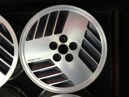

Did any Fiero 14 inch rims come in different widths or offsets? I thought that was only the GT/Formula 15 inch rims.
Though my Formula has 4 same size aftermarket wheels and they do stick out in front more than the factory 15 inchers did, because the factory front rims were skinnier and had a different offset.
This diagram is helpful:
Though my Formula has 4 same size aftermarket wheels and they do stick out in front more than the factory 15 inchers did, because the factory front rims were skinnier.
All Fiero 14" Hi-tech wheels are 14x6 35mm offset, 84-88. The 88s 15" diamond lace wheels had a 15x7 30mm rear (dimensionally the same as 86-87) and 15x6 37mm front.
Edit: Doh! Ninja'd by Joe Torma's pic.
