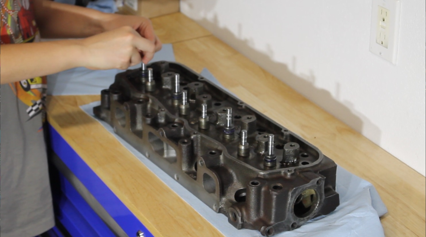

Not really... it depends on how worn the seals are. Hot oil is more viscous and will pass through holes much more quickly. When it's cold (unless synthetic), it will have less fluidity between the molecules. After a 6 hours or so... your car isn't going to continue to leak-down oil into the combustion chambers. You'd need to understand what the top of the cyl head looks like for that to make sense.
This is from one of my daughter's videos where she's re-assembling the cyl head on her Iron Duke (similar for the V6 and other pushrod motors).
The valves and the valve seals are quit literally one of the highest components on the car's engine. Any oil that's leaking down in there is going to come from whatever is immediately sitting there on or around the valve seal from having been splashed with oil from the pushrods. Now, this is an Iron Duke motor which stands perfectly vertical, but in the V6/60, they sit at a 60 degree angle (give or take) and the only "other" oil you're going to get is whatever has pooled in the rocker arm once the motor stops, and any of that continuing to drain down onto the valve and the valve stem... all of that should have drained down by the time the car cools off.
So... really, you're going to see a puff of smoke... probably from having the car sit anywhere from 2-6 hours. I'd imagine some of the oil will burn off early while the engine is still sitting at core temperature for 20-30 minutes. But anything after that is just going to pool on top of the pistons.
EDIT: I don't know if this is an "old wives tale," but they say adding ATF / automatic transmission fluid can extend the life of your gaskets by causing them to swell. The automatic fluid won't hurt your engine because it's essentially just formulated hydraulic fluid.
