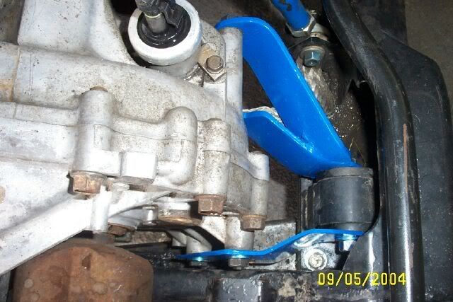

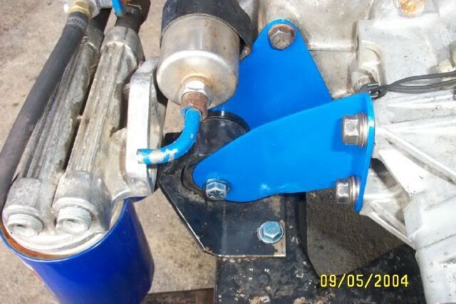

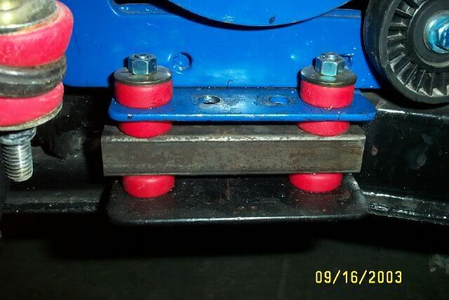

For my first SBC install, I modified the front Archie mount so it was poly mounted and ran poly transmission mounts. As the stock transmission mount brackets bent, I remade them in thicker steel. Once they wouldn't bend, I started to crack the rear crossmember on the cradle (88) and after the second crack I went full solid mounts and never had to touch them again.
Here is the poly setup with the remade transmission mounts:
The issue with this first attempt was the poly engine mount wasn't very good at resisting the drive line torque, so the transmission mounts and torque strut had to do most of the work.

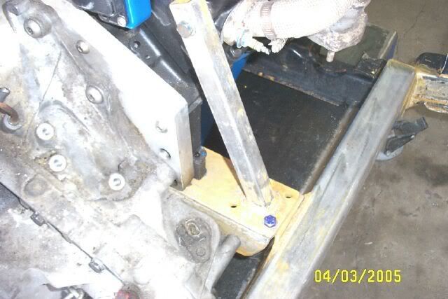

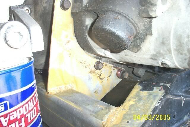

Here are the solid mounts I replaced the poly setup with (ran these for 40K miles and never had to touch them again):
For my personal swaps I have started to run 4 rubber control arm bushings for the drive line mounts. I try to get them spread about 24" apart front to back to they have good leverage to resist drive line torque. To do something similar to the SBC, you could mount one of these round rubber mounts (or upgrade to poly) and round off the corner of the Archie bracket to fit the bushing between the engine bracket and the AC compressor. For the rear you could come off the stock SBC engine mount pad and make a mount bracket that goes down to the cradle like this:
