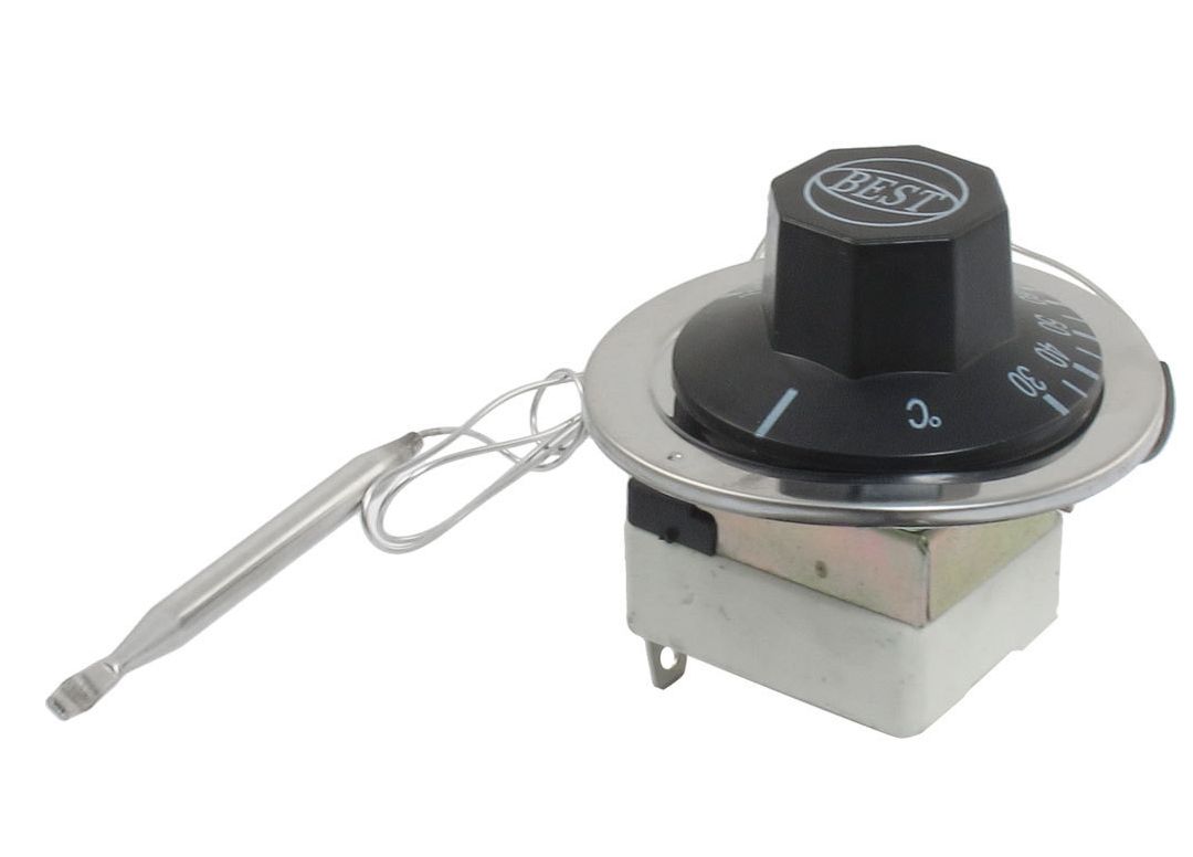

Here is what I did: I bought this thermostat and installed it next to the radiator input hose by the healight. Then I just zip tied the sensor to the input hose on the radiator. Wired it into the relay in parallel with the engine temp switch. I just set it to whatever I want the fan to come on at, Works perfect and you can adjust it to your hearts desire. Best of all is that they cost you $11.00 delivered. Larry
