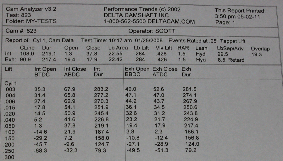

It has a agressive cam, very small LSA angle (99 degrees) and lots of overlap. It runs exactly like it should with that cam. Idle is lumpy at 1,200. Larry
