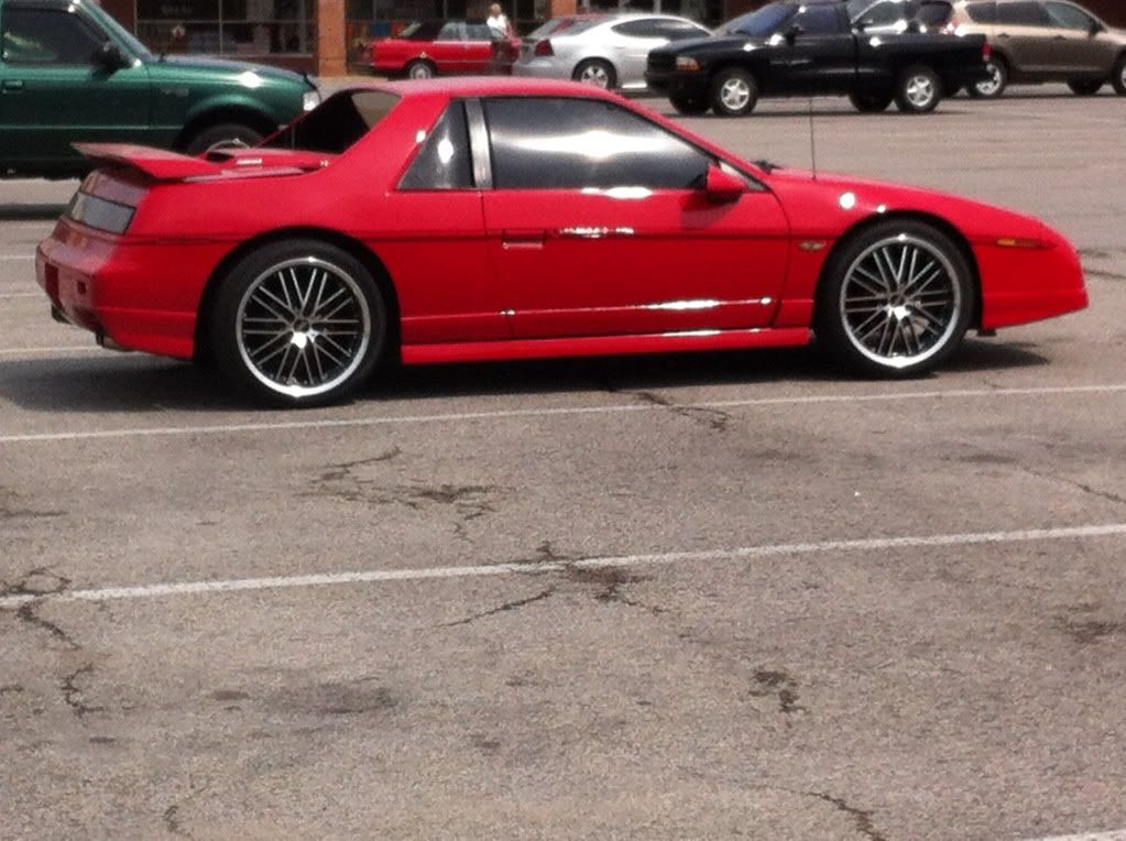

I just upgraded to 18's on all four corners of my 88 GT that I've owned for 15yrs. On the front I'm running 225/40 and rear 265/35 with absolutely no issues. Btw wheel offset is 47mm. Hope this helps you.

I have 18x8's, 35 offset and running 225/45's no issues
