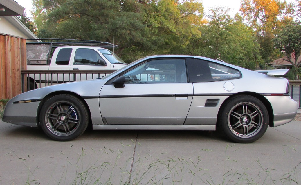

Like you decided I wanted to add a little low to my car, an '87 GT with an '88 cradle. It came to me with rear coilovers so that part was obvious. For the front I looked at a bunch of options but in the end decided to start with the cheap one - cutting springs. I chopped exactly 1 coil off, which ended up being somewhere between 1" and 1.5" of drop. I'm happy with the result - it reduced the fender gap to an acceptable level without fully putting the car on the ground. Visually, it could be lower, but I just wasn't willing to give up that much ground clearance and suspension travel to do it.
Edit: I should mention that the the tires on the car are larger than stock OD - 225/45-17 in front and 245/45-17 in back. That's +0.3" diameter in front, and +0.5" in back. That reduces fender gap just a little without actually losing travel or ground clearance.
