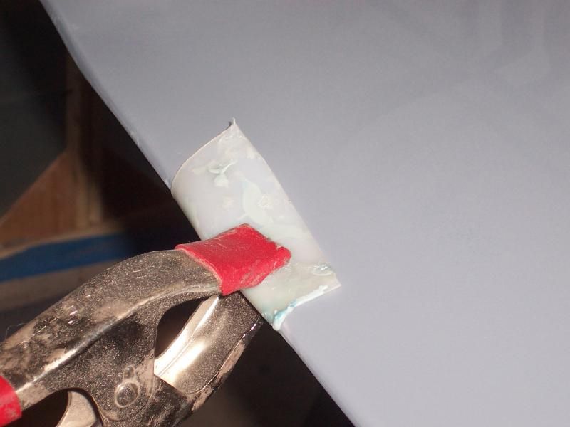

Sometimes it can be a PIA to get body putty/fiberglass to stay put while it dries, especially on an edge. I've found a simple solution; just hold it in place with slick plastic like that from a blister/bobble pack or in the case, a section cut from a cat litter container. The putty/F-glass won't stick to it. I've also used it to repair trim items like side moldings with fiberglass with great results.

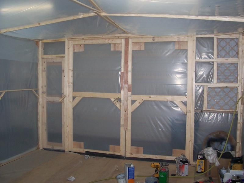

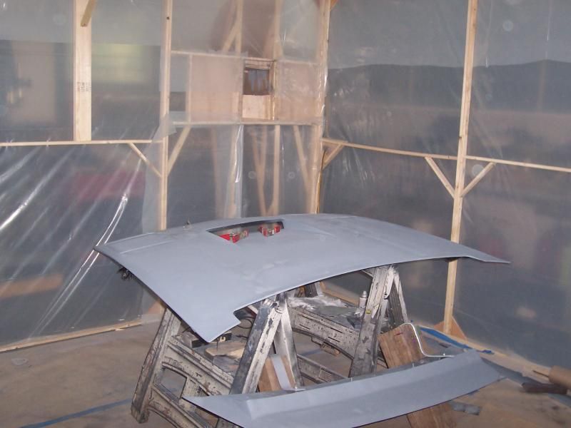

BTW: That's my DIY 12x16 paint booth and the front lid and DIY whale tail I'm working now. Car will be in next. The lil square hole in the wall has very strong fan inside it with an 8" dia vent tube out a window. Works great.

I use wax paper in a similar way.

I just use masking tape. Another little trick is filler wont stick to the smooth side of masking tape, so if you building an edge at a seam, you can cover a piece of cardboard with tape and insert it in the seam and just push filler in it. After it hardens, you just pull out the cardboard for a nice clean edge. I do that on door seams especially all the time.
