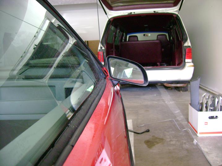

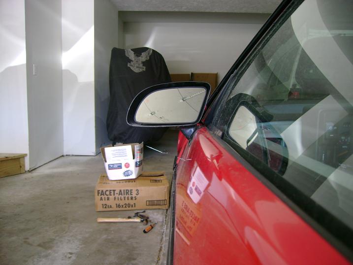

Report this Post07-28-2013 11:30 PM Click Here to See the Profile for KhwSend a Private Message to KhwEdit/Delete MessageReply w/QuoteDirect Link to This Post
Originally posted by fierogt28:
Unless the camaro / firebird / corvette have the same GM part numbers?
I'm not sure if they did or not but here is a picture of a corvette (red) and fiero (black) mirror. You can look at yours in comparison to the picture and see if that's the cause.
You can see thet the arm is shorter on the corvette mirror.
Also a comparison of how the Camaro mirror sits when on the door.
Fiero
Camaro

Khw, my drivers side looks exactly like the installed pic (passenger) of the "camaro" mirror you posted.
The passenger side is normal, no issues there.
I'll have a look again at the mounting on the mirror, but again...they both share the same part #.
BTW, I appriciate the photos...
