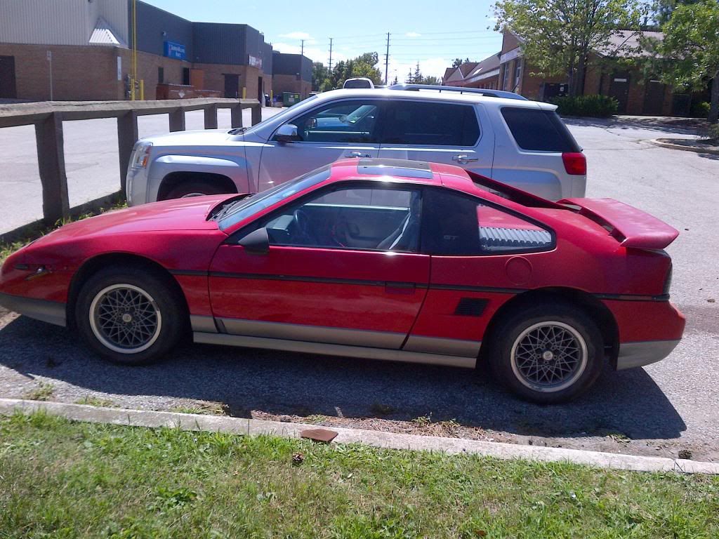

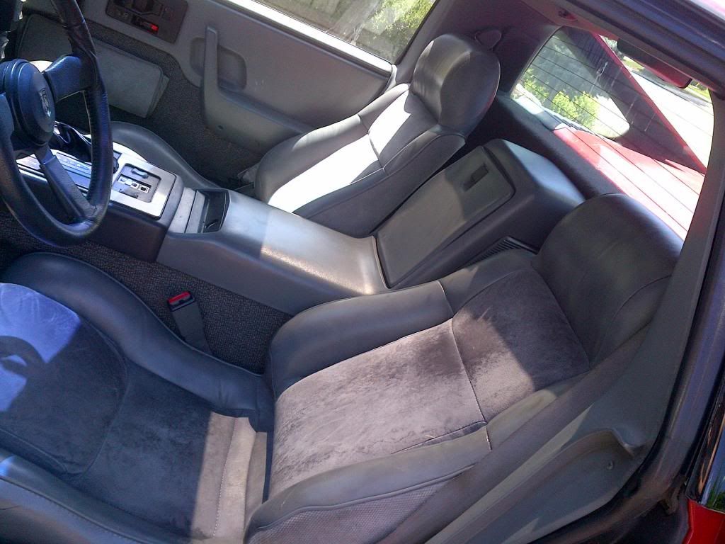

Nice car, factory leather with suede seats. Except for the spoiler paint could probably be buffed up, though faded lighter some on top.
Someone here will have that blinker piece for ya I bet, or they can be bought at http://fierostore.com/

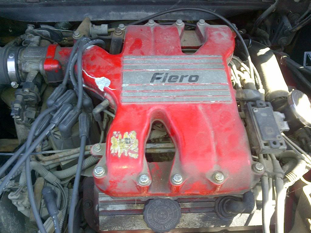

I wonder whats with that yellow engine sticker?

I believe the yellow sticker is the 'recall work completed' sticker. My 86 has one too but they were nice enough to put it under the trunk lid, not on the intake.
