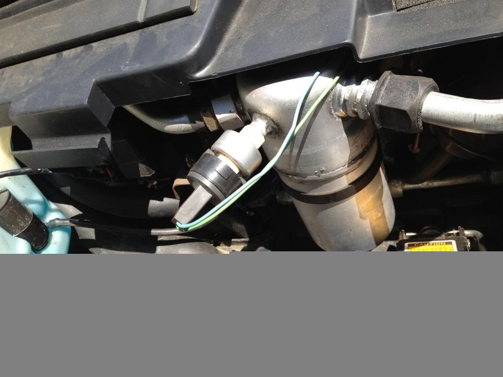

Hi guys -
I had my car converted to 134a about 7 or 8 years ago and this summer I've noticed that the compressor seems to be short cycling (10 second bursts or so) and I wanted to try topping it off before assuming that it was anything more serious. As I always do, I came here to make sure it was a straight forward process, and then went out and picked up a can of coolant.
Now, this is where my confusion comes in. According to the pictorials here most people have a low side quick connect port with a blue cap on it that is used for filling the the canister. Mine, however, has some big ol' electrical plug put in there. What gives? Where would I hook up a recharge on this beast?

that is the pressure switch that makes it cycle. you CAN just unscrew it (you will lose no Freon), screw on the 134 adapter, put in a can of 134, then remove the adapter and put the switch back on. although, there should BE 2 ports on that line, 1 for the switch and 1 for the 134 adapter. Look at the "LINE"

I bet there's another port that's hidden behind one of the metal lines.
The correct accumulator has two shrader valves - the one that you show with the sensor installed, and then another one on the other side, where the sensor SHOULD go. My guess is that the sensor was installed on the wrong port. But no worry - the sensor simply unscrews from the accumulator and you don't even have to drain the refrigerant to do so.

Unfortunately most aftermarket 85-88 accumulators have the ports in different locations than the originals. I bet you there's one where this yellow X is.
If you're lucky it might even have the R-134A adapter on it already. Even luckier, you MIGHT be able to get a hose onto the fitting!

remove that plastic cover( 3 screws) it'll be easier to see

You're awesome, as always! Sure enough there was another hookup on the backside, fitted with a r134a adaptor and blue cap. On top of that luck - I was able to get the hose on it and had it filled up in a jiff!

Looks like whoever worked on your car put the cycle switch where the fill port goes, and vice versa.
