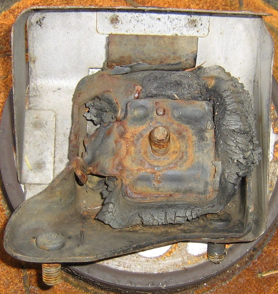

Your mounts probably look a lot like this one:

Report this Post07-05-2013 11:43 AM Click Here to See the Profile for carbonSend a Private Message to carbonEdit/Delete MessageReply w/QuoteDirect Link to This Post
That looks like a few more miles than 77k, but that's the idea.
