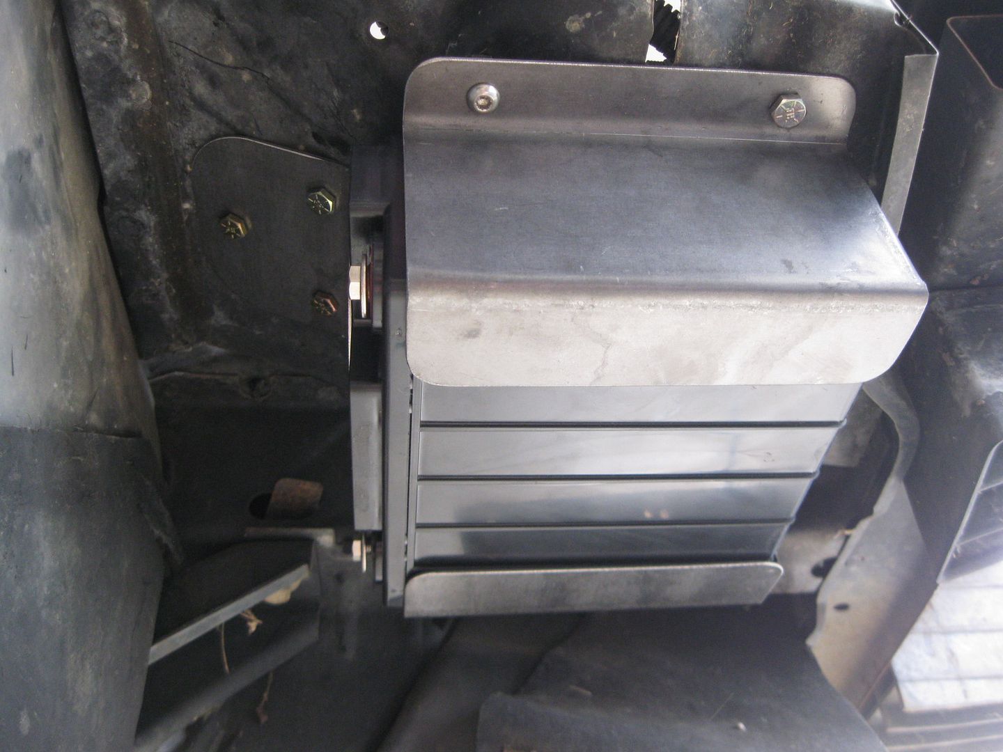

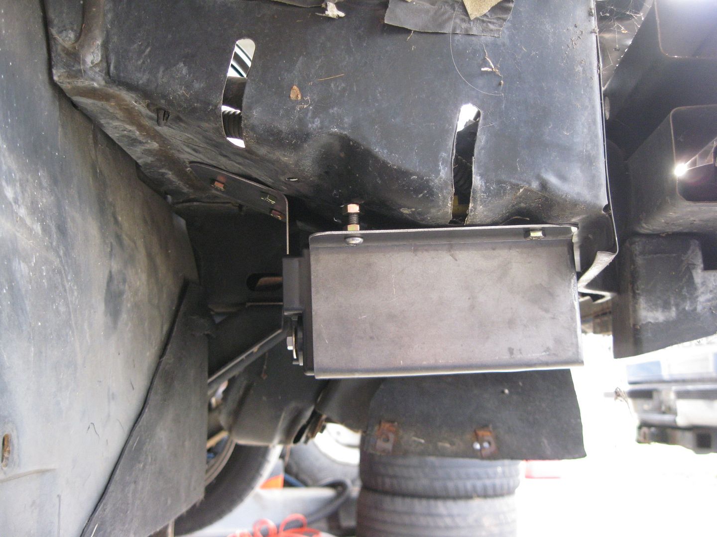

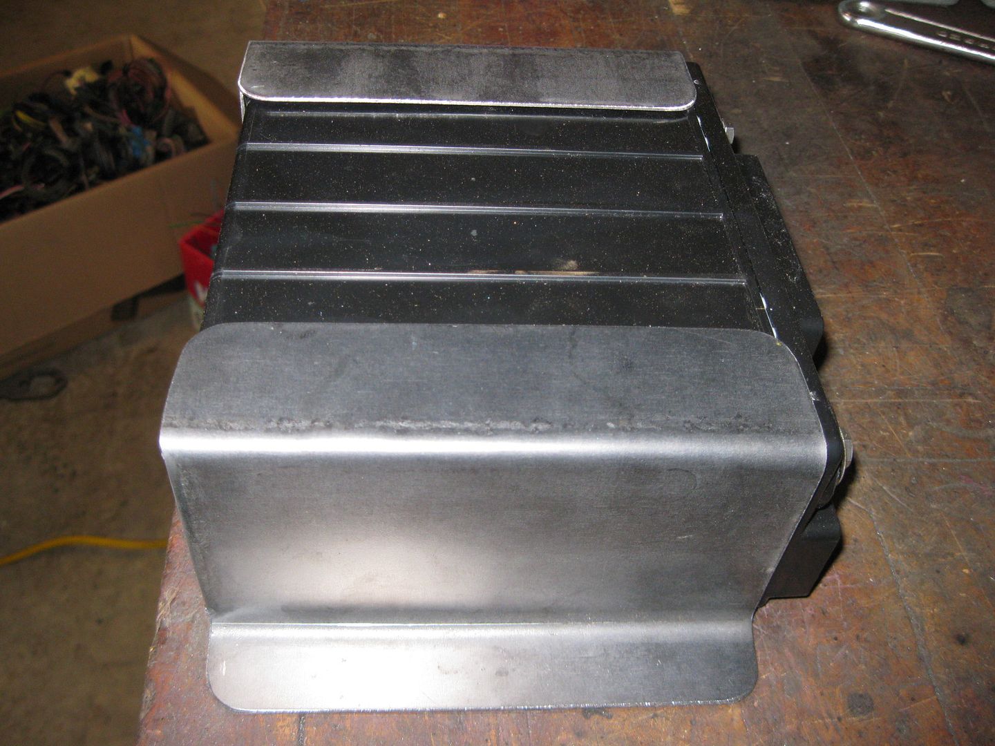

Then I worked on the battery mount. I fabbed up these brackets to hold the battery, but ended up unbending one of the bolted flanges.

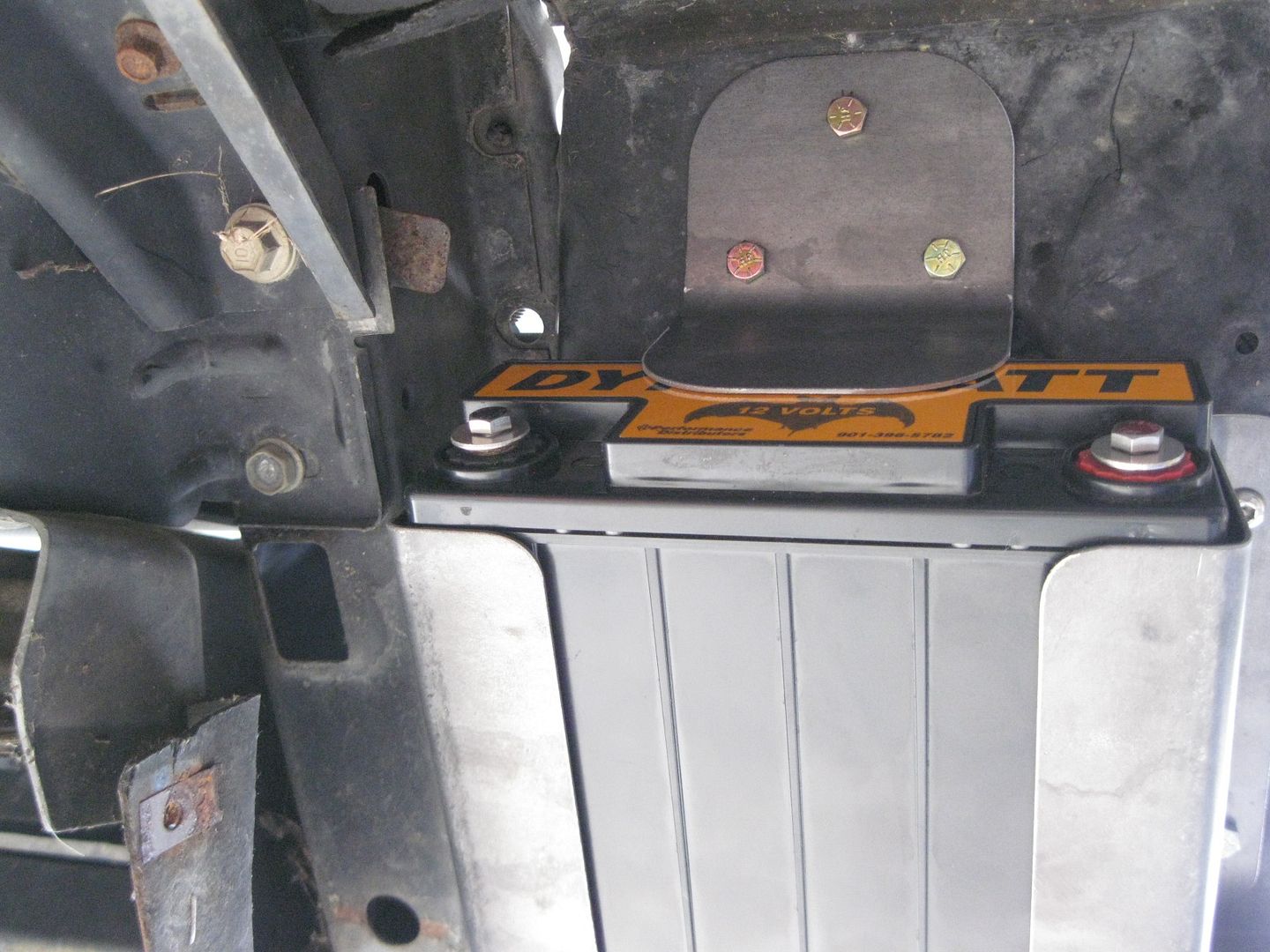

The battery is now mounted under the passenger head light, but the only modification to the sheet metal in that area was to drill seven 1/4" holes and remove the protruding flange from the 1" diameter drain hole on the bottom side. In the first picture you can see that the battery easily clears the bottom of the 88 coupe fascia (notice the 2 bolt air ducting bracket on the other side of the battery).
The mounting bracket holds the battery firm in 3 directions and the batter hold down tab secures it in the 4th direction.
