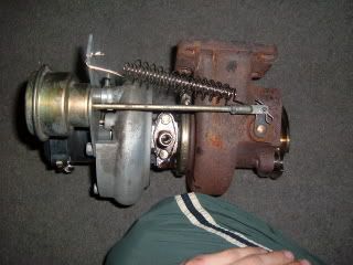

So after a little research the stock mechanical limit for the internal evo wastegate is 11 psi. Is this too much to start with? I ask this because on pretty much every turbo setup I have seen, the boost will be set low to start out with.
Also just one more thing to take into consideration... The SD head gaskets I have are definitely taller than stock, effectively lowering my compression ratio. So lets say stock is 8.9:1. So at 8 psi I would have (14.7+8)(8.9) = 202 psi vs 8.5:1 and 11 psi is (14.7+11)(8.5) = 218.45. It is roughly equivalent to running 9.8 pounds of boost on stock compression. Too much?
Also who makes a quality rising rate fuel pressure regulator? I guess the real determining factor for if I get one of not would the opinion of the person who is going to be tuning my car (unless I decide to do it)
[This message has been edited by zkhennings (edited 06-28-2013).]
Slowbuild
Posts: 252
From: British Columbia
Registered: Nov 2009
Report this Post06-28-2013 12:10 PM Click Here to See the Profile for SlowbuildSend a Private Message to SlowbuildEdit/Delete MessageReply w/QuoteDirect Link to This Post
Don't get me wrong, the rrfpr will allow you to squirt more fuel in there. It just may not be necessary given your choice to use bigger injectors.
The 11psi thing doesn't mean a thing until you actually try it on a 2.8 the reason for that is that when you change the engine it's on, the wasegate effect changes.
In other words, to apply this turbo to a V8, it will take way more air than the turbo can make and you don't need a wastegate at all. Put it on a 3 cyl 1L engine and it will need a big wastegate.
However, beign that we 'think' the airflow of a 2.8 is sorta similar or a bit less than the 4G63, I think the external is a wise choice. This is the reasoning that I used in choosing an external. The internals are pretty small, and I think they are suited to higher psi ranges.
I'd try starting at about 5-7psi. This is the lowest setting on my massive wastegate. It cracks at 4psi, fully open at 7psi.
You'll find as you get into it that wastegates are an art form unto themselves. They can be a bit unpredicatble depending on air flow, temp etc.

Ok I understand that on a V8 a small turbo wouldn't push enough air on the cold side to make good boost, so you would not get to the pressure the wastegate opens at anyways, but as long as the turbo flows enough air to make enough boost, shouldn't the size of the wastegate not matter? Regardless of the engine it is on, won't it open when the intake reaches 11 psi? It has a spring and diaphragm that will open at 11 psi of pressure, will this not always be true no matter what engine it is on? Some engines are too small and won't flow enough air to spin the hot side, some engines are too big and the cold side can't push as much air as they need? But other than that, shouldn't the wastegate open at 11 psi?

You're correct, the wastegate will open at 11psi on a small engine.
However, if the wastegate does not flow enough (too small) the extra exhaust will contiunue to spin the turbine faster causing continued increased boost. This is referred to as boost creep.

Slowbuild, I think the stock wastegate will be ok in that regard because the lancer stock runs 19 psi of boost (with the boost controller) If the wastegate can keep it at 19 I bet it opens enough to keep the boost at 10 psi (unless I totally misunderstand the boost controller and there is a separate bypass for exhaust gas besides the wastegate)

My only concern with the stock EVO gate, if it is an 11lb gate, I'm worried 11psi is a big first step, I would personally prefer to start at 5-6psi and work my way up from there (but i;m a big baby LOL) . That said, as long as the car has a good solid tune on it, enough fuel and the bottom end can take it all will be well. All you guys with the boosted 60deg's have established the motor can take 11psi, I think I would talk this issue over with the tuner.

Is there an adjustable wastegate actuator for the EVO turbo like those for the T3 internal wastegate actuator?

I know Turbosmart makes one for the EVO 7/8/9 but the base spring in 14psi there are most likely lower spring rates available, but at $150-$200 it costs as much as a good External WG

I agree, plus I was just looking into lowering a internal waste gates preset PSI and I found some guys using external springs attached to the Internal gate.
also the turbosmart IWG actuators have springs available as low a 3psi and as high as 26psi in the evo I think this is the way to go
