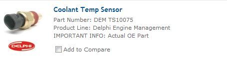

As always when amateur mechanics get to work there are some unexpected things that come up. I am going note a few for future generations and historians
1. I like to call this section :"Buying an IAT:Naming Convention Blues" Pyrthian described it as follows "...... in the air filter can (IAT), which measures the air temp" which by the way is a great description since I was able to locate and identify it easily by first googling IAT (I especially liked this gem: "IAT stands for Air Intake Temperature Sensor and it is located in the intake tube"...dyslexic much?) and then looking at the air cleaner. Ok so far so good...I then searched to see what was available online. Keep in mind that I haven't seen this part nor taken it the old one out of the car. This is what I found
Notice the same part number on the Napa site....geez. Same part .....2 different names...awesome. Needless to say I wasn't inspired with confidence when I went to the store....then the guy at the counter couldn't find it ...then he handed me a part and asked if "this" looked like the right part (since I hadn't pulled it ahead of time....I answered "I don't know"). Anyway...When I got back home I immediately pulled the old sensor and yes ....it was "this" was in fact the right part...and if I had pulled it first I guess I would have known that ....the problem is that I loath to pull out a part until I know for a fact I have the replacement in hand....too much bad crap can happen when you remove an old part and then have to put it back. The installation of the new part went like a charm.

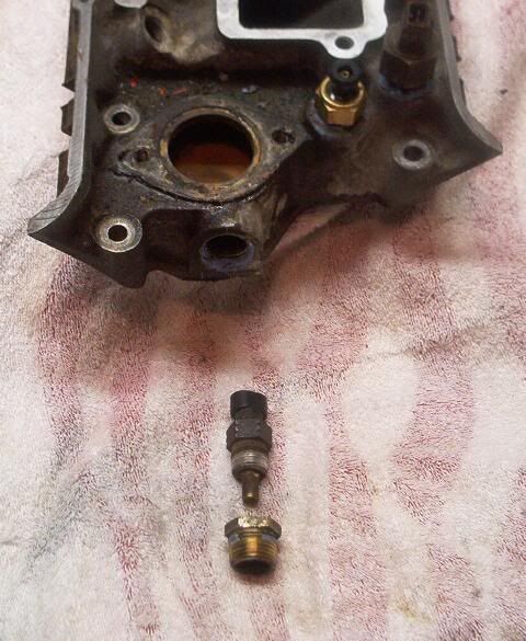

2. The CST ...or Coolant Temperature Sensor. This was not too big of a hassle to identify ....they just called it a "Coolant Temp Sensor" and plopped it down in front of me with some confidence.
When I went to pull the old part however, I found it was buried under some other stuff...I kept having to refer to various pics and diagrams to first identify where to look and then look at the right angle to actually catch a glimpse of it. I had to remove the connector blind because it was underneath everything by holding a thin screw driver with my left hand and pulling back the retaining thingy by feel and simultaneously trying to pull the socket out using just my thumb and index finger, which was all that fit in there...but I was successful..so alright. I also ended up un-mounting the ERG solenoid from its bracket and then removing the bracket itself to gain access to the sensor itself. Next I realized I would need a deep socket (3/4" I think) but I didn't have one ....I fished around in my tool box and found a spark plug socket that was almost the right size (using the new part as a guide) ...so I crossed my fingers and gave it a try and lo and behold it started to turn and I was able to spin out the old part!! Victory!! ....that is until I looked at the old part closely and realized that the threaded part was much bigger than the replacement's threaded part (the rest looked identical). [expletive deleted]!!!!! I almost jumped into my truck to head back to Napa yell at counter guy (I prolly wouldn't have yelled but still) when I took an even closer look and realized that what I was seeing was old sensor threaded into another threaded insert !! What the hell?! ....well regardless.... this was something I could work with. I did the whole 2 box wrench tango (I won't go into details but at least my hand didn't slip and smash myself in the nuts...so that is something) and separated the two pieces ...cleaned up the insert with a wire brush and threaded the new sensor and insert together (Box Wrench Tango II: Electric Bugaloo). Then used the spark plug socket again to thread it into the manifold until it was finger tight and finished it off with an open-end wrench. I replaced the ERG Solenoid and bracket. Finally, I filled and burped the coolant system and went for my test drive (I already recounted how that went earlier in the thread)....yay!!!
3. Minor detail...while I was wrist deep under the ERG Solenoid, I felt something loose laying there ...I fished it out and it was a (1/4" or 3/8") machine screw with a washer painted black...no idea where it came from. The extra parts god gave a gift again....only this time swear it wasn't something that I removed and forgot to put back!! Seriously

Report this Post06-30-2013 08:21 PM Click Here to See the Profile for HudiniSend a Private Message to HudiniEdit/Delete MessageReply w/QuoteDirect Link to This Post
I found that removing the dog bone bracket helps clear the biggest obstacles in that area.

Report this Post06-30-2013 08:50 PM Click Here to See the Profile for 92wastheyearSend a Private Message to 92wastheyearEdit/Delete MessageReply w/QuoteDirect Link to This Post
I wonder why they went with that threaded insert?

As far as the insert:
From what I've read, the original CTS used a "weatherpack" electrical connector. Later replacements use the "Metripack" connector. Some of these were sold in a kit that included the replacement connector. I wonder if the original CTS filled the larger opening, and the insert was added to fit the metripack sensors? That's just a guess. I've never seen the older style CTS.
From what I've seen happen to my metripack connector, I'm not exactly sold on it being an improvement. It's wrecked worse than any of the weatherpacks on the car, and that's saying something. The pins are also closer together, which doesn't help it's robustness any.
I think I really prefer weatherpack, and at minimum those connectors are easier to replace. But I guess the weatherpack sensors are unavailable so it's not an option.
