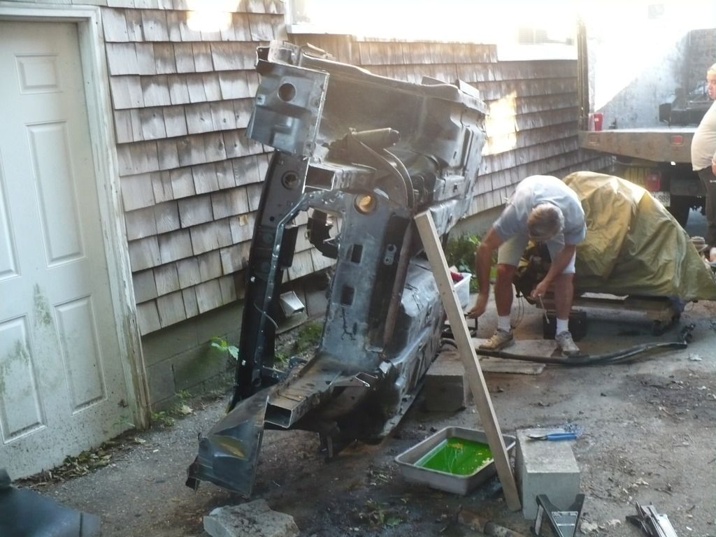

If it is the first time it is coming apart... expect a while. I took mine apart last summer, and the seat nuts were totally fused and almost gone, and those alone took me a day to get off. Your best friend will be crc freeze off, it is different from every other penetrating oil because you spray it on the frozen part for around 30 seconds to actually freeze and break the bond between the two parts. Cradle bolts are tough too usually... Metal rivets on the body panels can take some time... I know what I am doing, and because I stripped the car down before, there are no frozen bolts, and I would estimate around 6- 10 hours to totally strip it down. A stuck bolt can take up to an hour so for a never stripped down car that number could vary a lot.

Two days IIRC.
https://www.fiero.nl/forum/Forum1/HTML/090279.html
Bring a saw-zall, good pair of mech's gloves, plastic totes or boxes, trash bags. Lets see jack stands or blocks.
I started by pulling the doors as you recommend, it does make life much easier. Dropped the cradle et al., cut rear cross members off, then roof and pillars. After that it was pretty much hack and slash. Made sure I put my stands and blocks toward the center. Work smart and safe. Dust pan and fox tail for periodic clean up.
