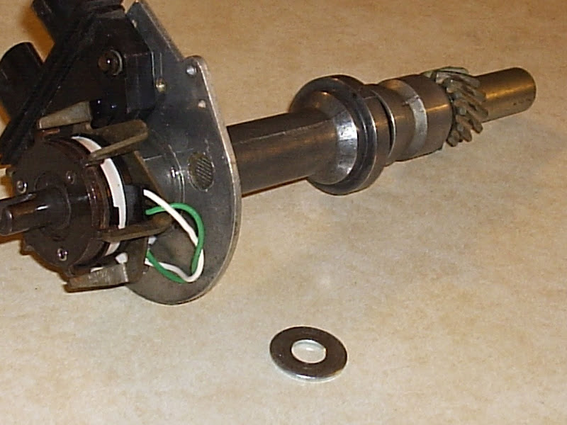

Rodney, I changed out the pickup coil in my stock distributor and it just seem to float in there.
I realize that the shims on the shaft are probably suppose to keep it still but mine were worn.
It did ok for a while but finally got to moving around so much it wasn`t dependable anymore.
I bought a new Richporter Technology distributor and the pickup coil is actually mounted on a bracket.

I put one of the new-style distributors in my car. Actually, I did it a little differently than most - I used one I found in the junkyard. It was from an '85 or '86 Chevy Celebrity with a 2.8. While the car was pretty beat and the engine was a filthy, leaky oily mess, the distributor looked like it was almost new. Works fine in the Fiero.
I was surprised to see how much endplay (up and down) there was in the shaft. I don't think it necessarily matters, but since the old one I removed had almost none at all, I decided to shim mine. Jegs has shims; mine were from Moroso.
Anyway, I can't tell if the car runs any better with the new distributor. My old shaft was pretty tight with caked on burnt oil, so I suppose at least the new one probably spins more freely. That's gotta be worth a few HP LOL...

The Cardone distributers (sold at your local auto parts store) have the new "star wheel" design.
can you buy just this type of pick up on its own or do you have to buy the complete distibutor?
jon

Originally posted by jon m: can you buy just this type of pick up on its own or do you have to buy the complete distibutor?
The Cardone distributer and stock distributer use the same pickup coil. The difference is in the design of the distributer body. So you would have to buy the whole distributer.

right so what your saying is that the new style pick up coil will not fit on the old style distributor?? like what is the 2nd posting by fierosound.
Please note: I am not after or do not expect any power gains - I just want to rebuild a spare distributor and just add a heatsink to take some of the heat away from the ignition module.
If I can I want to fit the new style pick up coil with the star wheel - it looks like a better design than the old type i.e not collecting any crud etc.
I just want to know if I can buy this type and where to buy it from
All opinions welcomed
jon
Oh they all collect crud, all of them eventually, as far as heat sink goes, that is what the paste you put under the ignition module before installing it, don't forget it before you put the module in, it is supposed to turn the entire distributer body into a heat sink, I think, I could be mistaken, I was once I think, bust I was mistaken.

thank you steve - However this does not answer my question - Can you buy the new style pick up with the star on its own and will it fit onto a distributor which had the old style pick up on and if so where can I get one from ???
jon

Report this Post10-07-2013 08:26 AM Click Here to See the Profile for phonedawgzClick Here to visit phonedawgz's HomePageSend a Private Message to phonedawgzEdit/Delete MessageReply w/QuoteDirect Link to This Post
No, you would need to replace the dist shaft, pick up, and star assembly to do this.

I replaced my dist with a cardone ,seal from Rodney, heat sink from tlg I glued on with silver heat sink glue and silver heat sink compound from radio shack. No leaks and ran like a top. FL to n j
