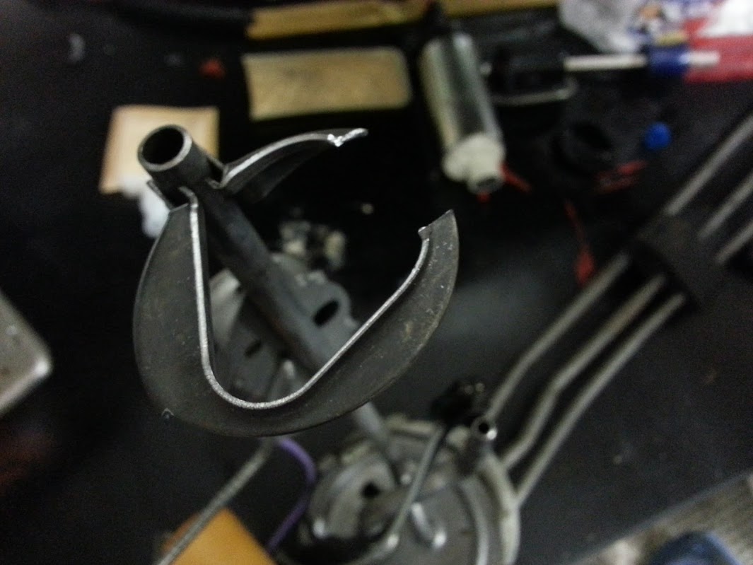

I installed DW200 pump last month to prep for 3800.
I cut a small notch in the bottom of the sending unit cradle for the sock to fit on (I DON'T think this is going to stay on due to tight clearance in the tank, I recommend finding a stock type sock that will fit or mount it so it faces the opposite direction of this picture)
It did install like this but it's a very tight fit, almost feels like you're going to break the sending unit. No problems so far though, and the pump is whisper quiet, even quieter than the stock pump it replaced.

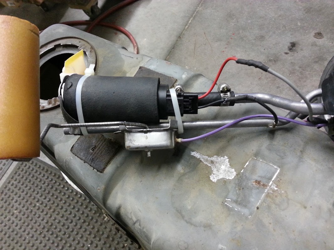

I took some pictures on the last DW300 install I did using the "universal" kit.

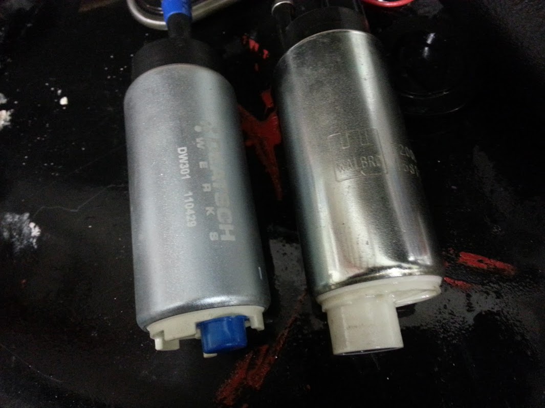

I went to the DW site and noticed the pump applications only differ by the pump screen offered within a given series. It looks like pump #9-201s-1005 or 9-301s-1005 with a 360 degree circular pump screen aimed straight down and pump #9-201s-1007 and #9-301s-1007 with a centered rectangular screen would be the best arrangements for our sending units as they allow for unimpeded fuel entry from directly below the pump inlet. Just a thought.
I also think with these it would be a good idea to try and angle the return fuel away from the pump screen as I observed air-ration in my liquid air intercooler pump when the return water splashed near the water pump located inside the water tank and I bet that can happen in this application if one is not careful with positioning of the pump screen which is already close to the return fuel outlet.
Here is a screenshot of the boosted area of my history table. I still haven't pushed the motor to the peak rpm output yet but the general trend shows the injector duty cycle increasing and although 14.7 psi is the max pressure the 2 bar MAP is able to measure according to my log I saw the boost gauge bound past 15 psi up as high as 18 psi by 4800 rpm before settling back down to 15-16 so the maximum value reached to date can't be shown in the log yet because the MAP sensor and code limits can't measure the values under those conditions although they are present. I estimate a maximum of about 40 will be reached if the motor is run to 6000 rpm and 18 psi, I'll be switching to code59 which can measure in that range to find out for sure.
Here are the pump screens I mentioned.
