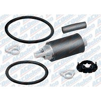

picked up one of these badboys today lol - EP 381. gotta say its way tinier than expected
