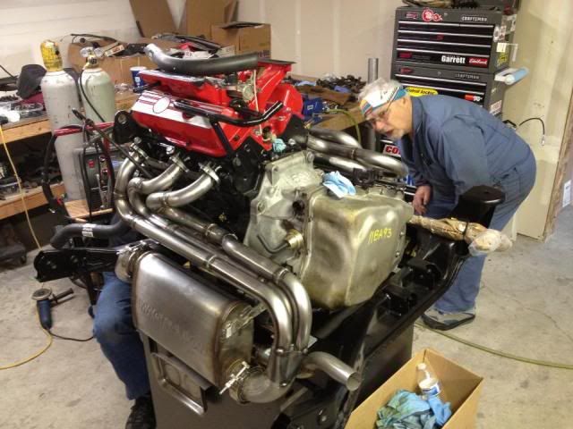

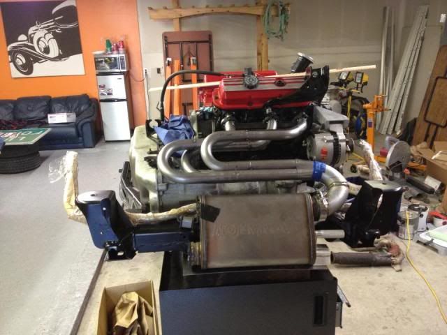

Where angels fear to tread ... When I commenced the quest to upgrade the engine to 3.4 660 and 4T60 tranny, I wanted to see if there was a better exhaust setup than the stock available. After alot of browsing, I felt I'd like to try a true dual equal length system. The short of it is, I bought Arns85GT headers with intent to use them. However, the trunk side would not fit with the 4T60 so elected to start from scratch. With tubing and collector and V-ring/clamp parts from Columbia River Mandrel Bending and Magnaflow mufflers, two helpers and I fabricated the exhaust system the first weekend of June. They are now at Finish Line Coatings for ceramic coating. Will they be as hoped? Only time will tell. Photos here: http://craigphoto.smugmug.c...2571895831&k=LQ7Rfvh
Beautiful work! What are you doing about the O2 sensor(s)?

Report this Post06-14-2013 01:38 AM Click Here to See the Profile for AsterixClick Here to visit Asterix's HomePageSend a Private Message to AsterixEdit/Delete MessageReply w/QuoteDirect Link to This Post
Fiero 660 has provision for only one sensor, would require extensive electronics mods to add a second one. Engine builder said, because of "consistency" of new parts from one side to the other, one should be fine. It is going into the collector just ahead of the muffler on the firewall side.

Asterix
Posts: 81
From: uSA
Registered: Feb 2006
Report this Post06-15-2013 02:58 PM Click Here to See the Profile for AsterixClick Here to visit Asterix's HomePageSend a Private Message to AsterixEdit/Delete MessageReply w/QuoteDirect Link to This Post
That is me in the photo. Johnny Spiva (www.polybushings.com) and I fabricated these and Damien did the majority of the final welding. The parts are currently at Finish Line Coatings (Russ Meeks, RM Engineering) in Milwaukie, Oregon, for ceramic coating. FWIW, Russ was our Tech Editor when I was Editor of Street Rod Magazine so I've know him for over 40 years. Damien is doing the engine build for me. I might also mention that Spiva suggested to use 1.5" foam pipe insulation to help mock up the primary pipes. I bought a length and cut a piece to 34" and that scheme worked perfectly for working out where each primary needed to be routed.
More photos are at: http://craigphoto.smugmug.c...2571895831&k=LQ7Rfvh

Asterix
Posts: 81
From: uSA
Report this Post06-19-2013 07:57 PM Click Here to See the Profile for AsterixClick Here to visit Asterix's HomePageSend a Private Message to AsterixEdit/Delete MessageReply w/QuoteDirect Link to This Post
I picked up the headers and mufflers today after having them ceramic coated at Finish Line Coatings, Milwaukie, Oregon. Added a photo at this link:
http://craigphoto.smugmug.c...2585463946&k=xvR25gr
More photos will follow when these are installed on the engine. And, yay, the aluminum gas tank (via Joe Solerno) was installed yesterday.

As for my installation, based on the info from Arn plus input from a friend that has been building performance engines for over 40 years and who holds several records at Bonneville, I then had TLAR Engineering do the final design. All three agreed there was no need for any H- or X-pipe.

Asterix
Posts: 81
From: uSA
Report this Post06-20-2013 08:16 PM Click Here to See the Profile for AsterixClick Here to visit Asterix's HomePageSend a Private Message to AsterixEdit/Delete MessageReply w/QuoteDirect Link to This Post
Oh, too funny! Not the same "TLAR Engineering" ... I've been using that "name" as a "joke" for 30 years for when I sketch a design (like a wing on the garage floor with chalk) and say "That Looks About Right" and make it. Had no idea there was a "real" TLAR Engineering. So, no, that TLAR was not who did the "engineering" for my headers. ROFLOL!
As for this build: it commenced over a year ago because I wanted an overdrive trans, then selected the GM 4T60 as recommended by Fieroking. Shorty after, I was introduced to thedrue who is only a few miles from me. After a session or so with him, I elected to do a complete engine/trans/88-cradle build rather than just swap the trans into our stock 86GT. The entire build was planned and spec'd along with the info (including math formulas) I got from Arns85GT about the "true-dual" headers. The engine-spec info was then provided to a company that does custom cams seeking their input, including "best combo of economy and performance"; I got a custom-ground cam from them based on their recommendation. So, IMHO, all the "patter" about "it won't work" and "it needs a crossover" and "equal length doesn't cut it" and the "cam" comments are wholly without merit. Am I right or wrong? Fact is, I don't care because I took the time to consult with people who have "been there done that" before I decided to proceed.
I do, however, regret that I failed to realize I shoulda-coulda gotten three Harley V-twins, modified the cases so a single crankshaft could be used, then mate that to a DAF continuously-variable trans. Life has it's hazards!

aaronkoch
Posts: 1643
From: Spokane, WA
Report this Post06-21-2013 04:07 PM Click Here to See the Profile for aaronkochSend a Private Message to aaronkochEdit/Delete MessageReply w/QuoteDirect Link to This Post
Asterix,
I believe it will work beautifully, and the even pulses will sound heavenly. I got so much crap from "experts" when I elected to use flipped f-body manifolds on my 3800 swap to make it sound like a 60 degree v6 you wouldn't believe it. Math usually works, and in my case it did, as it will in yours. Even if it could slightly benefit from a crossover (I'm not convinced it would), what would the difference be on an even-pulse fired motor? About 1-2HP tops? In my book the glorious sound would outweigh that anyway.
I hope you make it to fiero fest this year in Richland, I really want to hear your ride!

Asterix
Posts: 81
From: uSA
Report this Post06-21-2013 05:38 PM Click Here to See the Profile for AsterixClick Here to visit Asterix's HomePageSend a Private Message to AsterixEdit/Delete MessageReply w/QuoteDirect Link to This Post
aaronkoch:
Thanks for the kind comments. I can certainly identify with your "so much crap" experience. Unless something unforeseen prevents, I will be in Richland, had a great time there the last two years.
dobey:
I don't know why you chose (or were coerced into) a true dual setup for your car. It's really not relevant to the thread. The topic of the thread is "is it possible to do true duals in a Fiero?" and the answer is obviously yes.
Nobody coerced me into doing anything. I chose to seek an alternative because the stock Fiero exhaust system is restrictive and would be especially so on the 3.4. The alternatives I found were either no longer available or offered no improvement over the stock system. My quest led me to this thread and, after consulting with several people, I elected to "go for it." And, since this thread is "is it possible ..." and that I chose to proceed, what we fabricated is directly and specifically relevant to this thread. I kinda sorta thought the intent of any thread was to provide facts and data about a subject, in this case being "true duals." So, how is what we built and why we built it not relevant to the thread? Please be specific.
You've decided to do something a certain way. You disagree with others saying it's not the best. We get it. Leave it be, or partake in the conversation as to why it's not, and learn something, rather than trying to insult those you disagree with by attempting to condescend them.
Who is being insulting[interobang] Who is being condescending[interobang] Consider:
In what way is consulting with those who have "been there, done that" and "have experience" and are "performance engine builders" not relevant to my decision, and in what way is that not "learing something"? Please be specific.
In what way is a Harley V-twin exhaust system relevant to a 60-degree V-6 sequential-fire exhaust system? Please be specific, because these engines are so completely different (other than that they are reciprocating piston four-cycle internal combustion engines) that I question the thought process that brought that comparision to the table.
In what way is the need for H or X crossovers on a V-8 relevant to a 60-degree V-6 sequential-fire engine? Please be specific, because that issue was discussed earlier in the thread several times and was given due consideration when we planned the system we fabricated.
In what way are equal-length primaries not of any use? Please be specific, because there is a long-standing tradition of "bunch of bananas" equal-length extrator exhaust systems being used in performance engines. And directly relevant to equal-length is the length, as follows:
In what way is "primary length" not relevant to the design? Please be specific because the length chosen was based on mathematical formulas (and calculations) provided by Arn. (Also, the mufflers were chosen after consluting, by phone, with techs at MagnaFlow.)
In what way is the fact that the performance cam company was given engine-build specs along with the intended purpose for use of the engine not relevant? Please be specific because you and Will both mentioned "cam" as an issue.
What information in your and Will's posts have included anything, beyond your opinions, that are helpful to this thread or to what we fabricated? Please be specific, because, in my view, you are the ones who are being condescending. As I stated, if you don't like what we did, then don't do it. I note that aaronkoch asked how your swap was coming along . Would you be impressed if I commented that your swap was a bad idea without offering any specifics as to why? Probably not.
Hurt feelings[interobang] Unwarranted presumption on your part! You don't think what I chose to do is a good idea. I get it. Leave it be. And, as for "partake in the conversation as to why ..." is exactly why I've responded as I have, because you and Will have posted opinions that have no specific information, facts, or data to back up what you opine. In literary terminology, such opinions are classified as "glittering generalities." (And, "I don't care" means "I don't give weight to opinions that have no data to back them up.") So, what information have you provided that was helpful to me or this thread? Please be specific, because, in my view, nothing you or Will have said has been helpful or relevant.

Arn hasn't posted any calculations to THIS thread. He's posted numbers without note to how they were derived... Not having insight into the derivation makes them as useless as political statistics.
You haven't posted dyno numbers, so we have no idea how well your system works. You also have no idea how well your system works compared to anything else. You seem to think that because you did what math you know and the system gets exhaust gas from the ports to the tailpipes, it must be optimal.
I'm the only one in this thread who takes collector length and diameter seriously. If you don't take those variables VERY seriously, I have serious doubts about the effectiveness of your research.
Did you ask him for them? I did via PM and he emailed them to me after which we continued to communicate about the matter via email.
Insight comes with asking the right people the right questions.
Duh Oh! Obviously there are no numbers! The build is not finished!
See above.
What I "seem to think" is that it was worth a try after checking out all the options and consulting with others. And I have said several times (IF you had been paying attention) that I/we would not know until we had opportunity to do the real life testing.
That claim is so false it doesn't deserve a response.
Go ahead and doubt all you want to. If it works or not is not on your dime, it is on mine. And, as I commented to dobey, I consider your comments to be irrelevant because you don't include anything to support your opinions, and condescending and arrogant because you seem to think you are the only one who has any expertise. In fact, I've never questioned your expertise or qualifications; I DO question that you make derogatory comments without any supporting evidence. I conclude you have paid no attention to what I've said (in condensed version), "Here is what we're doing, we think it will work so we are gonna give it a try. We will let you know how it works out." In short, if you want a courteous dialog, then be courteous. Otherwise, "give it a rest."

Arns85GT
Posts: 11159
From: London, Ontario, Canada
Total ratings: 202
Report this Post06-22-2013 09:08 AM Click Here to See the Profile for Arns85GTSend a Private Message to Arns85GTEdit/Delete MessageReply w/QuoteDirect Link to This Post
You really are trying to make enemies, aren't you? You haven't followed my build threads or you would know that I researched true duals for about a year before I built them. Have you built any for the Fiero? So far as I know, Asterix has taken my work and built on it better and is to be congratulated. The exhaust is designed independent of the intake, with the intention of evacuating the gases the fastest way possible, independent of the intake. The cam and cylinder are taken into account.
The calculations I used were from the book entitled SCIENTIFIC DESIGN OF EXHAUST& INTAKE SYSTEMS third edition. by Philip H Smith FI MechE MSAE, and John C. Morrison BSe PhD MI MechE It can be purchased on Amazon for about $30.
Here are the extracted calculations I used.
I did not deal with the collector, because if you do some reading on V6 racing and performance, you will soon realize that the collector recommended is pretty big. So big that you could, in theory, run the primaries without a collector and make really good power, but really noisy. Those 32" pipes act like trumpets.
The Fiero has very little room, so, with 2.5" pipe I deemed the collector requirements to be satisfied with the tail pipe system.
So, Will, show me you know what your are talking about and not just taking cheap shots.
Arn
I asked nicely twice and didn't get a response until I was a dick about it... Hmmm...
I have the book.
What volume are you calculating in the 2nd panel? (I can see it's of a cylinder...)
Which reflection does this primary length use at peak torque RPM?
